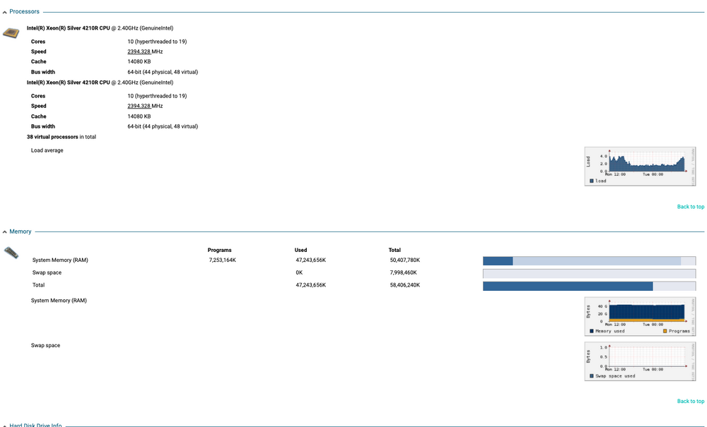

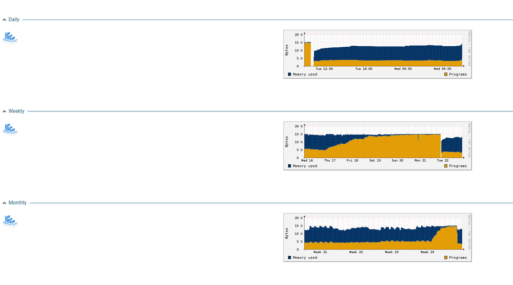

When looking at memory usage, the real indicator is swap usage. On the graph shown, only the yellow part is active memory use - the rest is caching. There is no swap being used at all. High memory usage is perfectly normal and expected behaviour - if the swap grows (you can click on the graph to get a daily, weekly, monthly, yearly overview) then there could be a problem.
