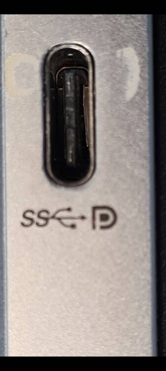

mullet_man Posted June 7, 2021 Posted June 7, 2021 We are nearly two years into laptops using USB-C docks and now starting to experience issues, broken dock leads and now a couple of ports on laptops being damaged due to wear and tare. Any ideas what this bit is that's in this port, it's blocking the cable going in, it seems like something from inside the laptop has collapsed into the port. Hopefully you can see from the image, am going to investigate it more tomorrow by opening up the laptop. It's a HP ProBook 450 G6. Cheers
chazzy2501 Posted June 8, 2021 Posted June 8, 2021 looks like a bit of the shielding, if you have a pin you could try and bend it out of the way (with power off). all the important stuff is in the middle bit. usbc is designed to wear out the plug not the socket but I figured at some point I'd be soldering new sockets. I also have the probook G7 and 8 so maybe I'll run into this next year. 1

mullet_man Posted June 8, 2021 Author Posted June 8, 2021 looks like a bit of the shielding, if you have a pin you could try and bend it out of the way (with power off). all the important stuff is in the middle bit. usbc is designed to wear out the plug not the socket but I figured at some point I'd be soldering new sockets. I also have the probook G7 and 8 so maybe I'll run into this next year. I'll have a look, I might take the back off and see if I can get at the port that way maybe and see what has fallen in? Yeah we are using USB-C docks replacing the old style docks you use to still the laptop onto (that seems to be a thing of the past) Our docks are the HP Universal USB-C Docks and the cables are hardwired and not user replaceable so I've got 4 docks that are not working, wondering if I could solder a new cable in it's place?!?! I like the one cable but am not sure on it's durability, but the big problem we have here is every teacher moves every lesson, which is causing the extra strain on cables and ports.

mullet_man Posted June 10, 2021 Author Posted June 10, 2021 We have 40 2 year old HP Elitebooks and 300 3+ year old Dell Latitudes. Having a quick look on our service desk we have had 0 reports of USB-C connector issues for Dell but 4 for the HP laptops. Although all repaired under warranty a 10% failure rate isn't good. I think the issue we've had this is the teachers are moving classrooms every lesson, so your getting 5 potential plug ins and 5 pull outs each day. Normally a teacher might plug in once in the morning and leave laptop plugged in all day. I've bought some of the contact cleaner spray that might fix one issue I have, but others one has a something that's fallen in the port from inside it looks like. When I ever get five mins I'll have a look by taking the thing apart.
