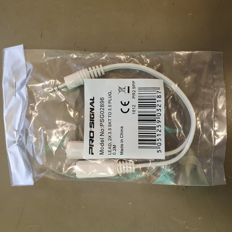

Used one of these.

Will see what happens when the adapter arrives.

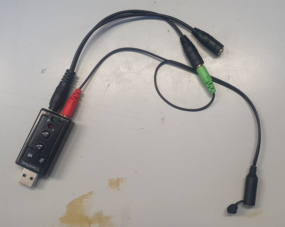

So it turns out the cable from Kenable allows for audio but doesn't allow for mic. The laptops only have 1x 3.5mm socket and this is a 4 pole socket. If the laptops had separate 3.5mm audio and mic ports it wouldn't be much of an issue.
Fortunately i had a usb sound card at home and a 4 pole to individually mic and audio connections and this seems to do the trick.
A bit messy but it works - things you have to eh?
So this allows 2 users to share audio to separate headphones and allows 1 of the users to use the mic on the headset.
