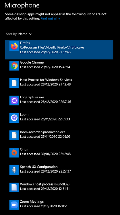

Windows 10 Microphone settings will tell you if an app is using the microphone:
[ATTACH=CONFIG]60297[/ATTACH]
[ATTACH=CONFIG]60298[/ATTACH]
Yup, checked that. Nothing is currently using the microphone.
