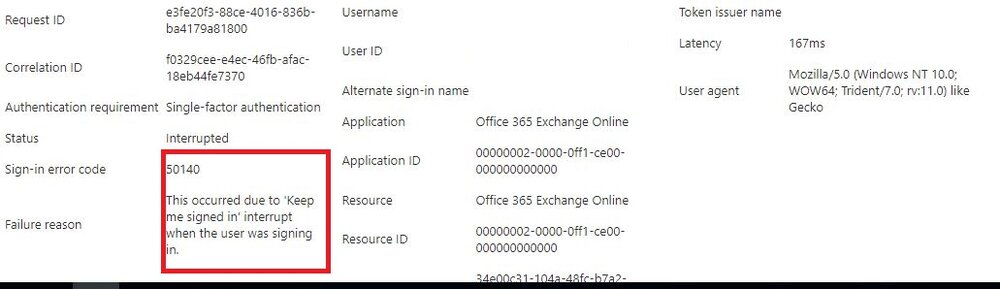

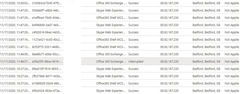

Tinribs Posted November 17, 2020 Author Posted November 17, 2020 Thanks Mako, Nothing unusual that I can see about his AD account: His Azure AD logon report shows this: The "interrupted" entry has these details: According to MS that error is generated when you ignore the "Keep me signed in" request on logging into OWA so I don't think that is related as we know he can sign in to OWA even if his Outlook doesn't let him... I can't think of any other logs to look for
