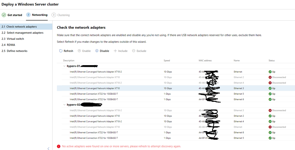

  11. Anyone any ideas on why the networking part fails. New Identical hosts. Fails networking with the error 'No active adapters were found on one or more servers' (see attached error)
  12. Apologies you did say you checked that already
  13. Check these settings?

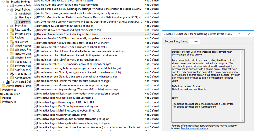

  14. A slightly related question, if you are using GPP to deploy printers then do you need to have the point and print settings configured or can this be turned off? I understood the print and point setting was required so that general users are not prompted to install drivers.
  15. Maybe this is the behavior of the current vulnerability?
