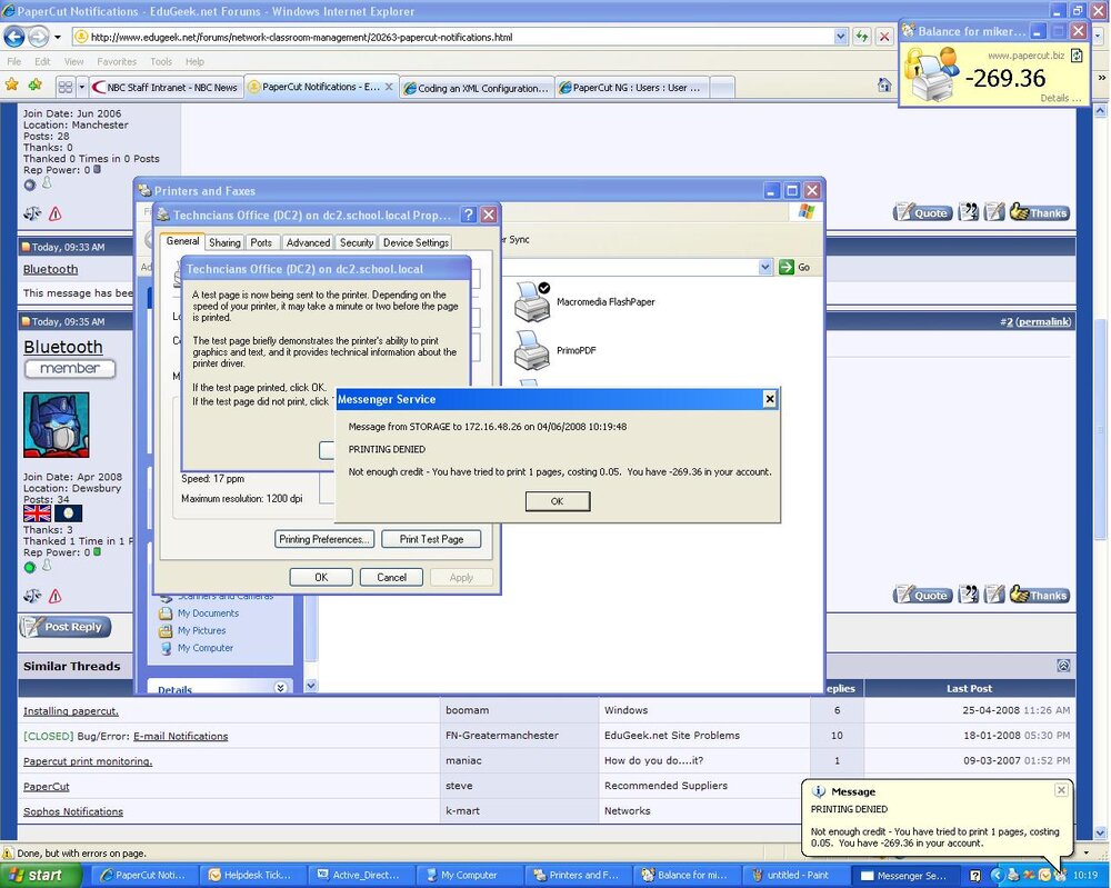

This is what my screen looks like if I try and print from a restricted account. I get two messages, one from the client software in the form of a balloon, and a popup from the messenger service as well.
