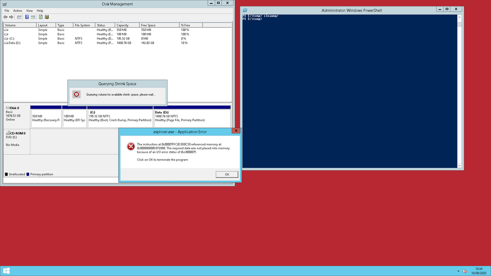

I noticed a server 2012 was running very low on space at the start of the week at one of the schools I look after. I advised them that when I am on my next visit, I will need to spend some time getting to the bottom of it.
I arrived an hour ago to find the following...
I am unable to open an Explorer window as the error just keeps opening whenever you click on OK.
I have managed to get CleanMgr running but it tells me it is able to free up 0 bytes.
I have attempted to shrink some of the D drive to see if I can then expand C but the wizard just keeps freezing so I am unable to free anything up.
Does anyone have any suggestions for how I can sort this thing out? This is not the first time it has lost a considerable amount of C drive but last time, I got to it in time before it went to zero.

See how big c:\windows\temp is and maybe delete the contents.
Maybe check the event log retention settings/size to see if that has been set to allow it to create huge files.
Thanks very much both. The reboot has helped. I managed to open up the version of Tree View I have. C:\Windows\Temp was 67.5gb which is currently deleting. Once this is clear, I will have a look at the event log settings as @pyorm has helpfully suggested.

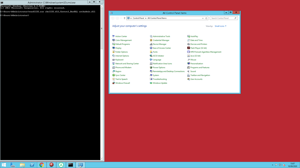

I had a server fill up on the Search Indexing size... worth a look, go in to the settings a Rebuild it.
Thanks for the suggestion. I have tried to open Indexing Options but it is not in my Control Panel. I have followed both steps listed on this site:
http://www.tomdoyletalk.com/2009/05/26/indexing-options-missing-from-control-panel-in-windows-vista/
But it is still not showing, so looks like there must be an issue there. I rebooted server after doing the registry edit, but made no difference, it still isn't showing in Control Panel.
rundll32.exe shell32.dll,Control_RunDLL srchadmin.dll
should bring up the options you need.
I think it must be broken... if I run what you have put in your last post in run, literally nothing happens. Tried it in command prompt also.
Have you actually got windows search feature installed? Otherwise might not be there :p
