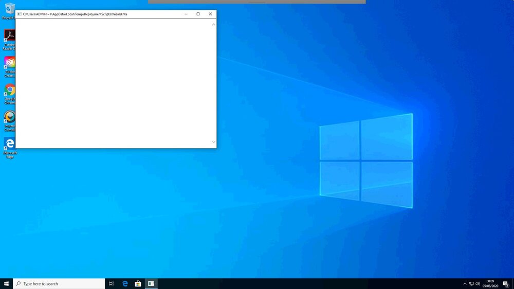

Hi All,
Wierd issue we are now experiencing;
Around 50% of new machines built on cat6 cables now freeze on a blank wizard.hta screen
A restart either thinks the deployment is complete, or constantly logs in as administrator or default0
This is on a new WIM of 1909
MDT 6.3.8450.1000
The others go to deployment completed successfully or report failure as normal.
Anyone else had this?
On a seperate note, some newer machines also take an age to download the NBP file, does anyone have any advice on this?
All my boot images are x64 as we run a purely 64bit environment now.
Regards,

I had this! It was essentially windows loading up a new driver for the network card, loosing the network connection which interrupted the task sequence causing this failure. I tired initially injecting the right drivers but that didn't solve it - bizarrely it still insisted on installing the older Realtek Drivers. The way I fixed it in the end was to put a 60 second pause in the sequence (essentially ping 127.0.0.1 60 times ) - just at the top of the State Restore group.
We had done 80% of the site without any issues, but then just hit this on a couple of rooms using newer PCs. Head scratching for a bit but works all ok now.

Hi Pete,
Thanks for this, can I grab a screenshot of the command/task sequence?
