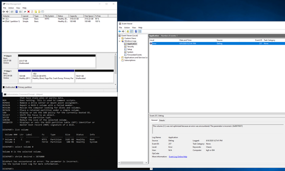

Is anyone else having bother trying to shrink the C partition in 2019 Server?
Mine had a 32ish terabyte C partition. Obviously this is not suitable and I want to make a D drive out of most of that space.
I was trying to shrink C down to 1gb and then realised that on the MS site, the minimum is 32gb. Tried that, then realised that you need to add an additional 4gb if you have the GUI which I do.
I keep getting errors. Not really sure what the issue is now as I am giving it the recommended size it is asking for. Does anyone have any ideas?
Unless my calculations are wrong....
3912gb=3912000mb
36gb=36000mb
3912000-36000=3,876,000 - this is the size I need to shrink C by.
Any ideas would be greatly appreciated. :)

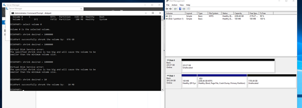

I mean I'd assume it's adding spaces where they aren't wanted :p desired=10 etc
Might be worth a quick try before going forwards too far looking into it

As Domino has mentioned about paging file, I tried to set it to 2 tb, but it was still not happy with that.
I currently have 1705gb allocated but 2206.46gb allocated to C.
If I do as you mentioned steve and do shrink desired by 10, it will successfully shrink the volume by 10mb so it is able to shrink, but there seems to be a limit on how much.
I have managed to get the C partition down to 1.91TB however, this leaves me with just under 2tb available. This is not going to be enough as on our old storage server, we are currently using 2.5tb of 5tb.

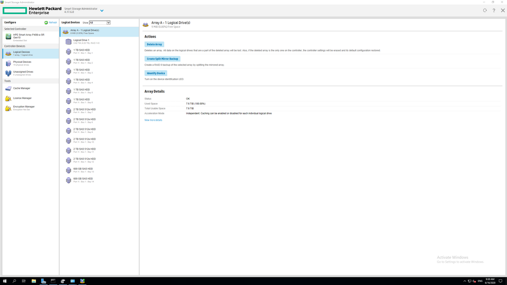

It looks like I need to make the raid bigger. I am running a RAID (1+0) RAID 10.
The total usable space was 7.6tb but over the RAID 10, it gave 3.8TB of usable space.
I only have 4 spare slots in the server.
What should I do? Put an older version of Server on that doesn't need terabytes worth of C drive space? Or buy some much larger drives to fill the remaining four slots?
If anyone could give me some advice, would really appreciate it. HP are not interested saying it is a software issue so they won't offer me any support on this.

Hi everyone, having a bit of an issue. When I deleted the old RAID over a week ago, it set the old drives to be erased. I have come back in today and most are done but there are 6 x 1tb still not erased fully. They are at about 91%.
I really can't wait any longer to install the new ones. Does anyone know if it is possible to plug these drives into a standard SATA USB connector and format them from a Windows computer? Have never known it take so long.
The current drives are HP 10K SAS 1TB 870794 drives. Unfortunately, once I pouplate the server with the new drives, there will be no more vacant slots for me to be able to format them using the RAID configurator after I have put in the new ones. Any advice would be greatly appreciated. I only have the day today so was hoping to insert the new 2tb drives and proceed with getting the new RAID configured and Server 2019 back on the server.
I'm not sure what you mean by setting the drives to be erased? Destroying the array will destroy any data.
Well when I deleted the RAID, it gave me the option to erase the drives. However, that was over one week ago and six of the fourteen drives are still being erased with a progress of 91%. I just don't think I can hang on much longer. However it is erasing them, it seems to be very thorough. Just don't want to ruin the old drives if I turn off the power. And was wondering if I can do it another way with a windows PC myself?
