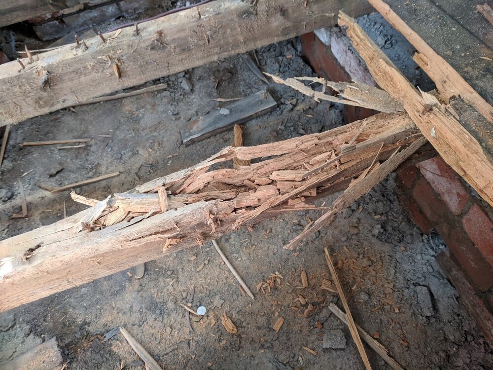

Floorboards this morning, and we've pulled up the rotten one where the leak was, and has as someone suspected, rotted the beam so that will also need replacing. So I've spoken to the flooring company already this morning as they're due in next week, and they've said they'll replace all rotten beams and charge on an as is basis.
My builder friend will replace the vent later in the week to prevent further damage as the duct tape may not be enough, but so far...and look at doing a damp proof membrane whihh won't cost too much, before insulation of the walls. It's going on schedule so far but as suggested by some, I will need to make a few calls to push some people back a week.

Took about 15mins to get my floor up - mind you...
[ATTACH=CONFIG]54838[/ATTACH]
Wow - good job you took it up - the alternative would have been you, the floorboards and the joists all moving down suddenly
