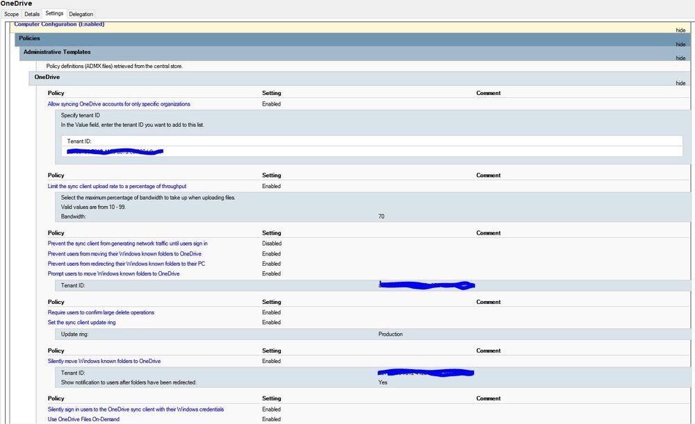

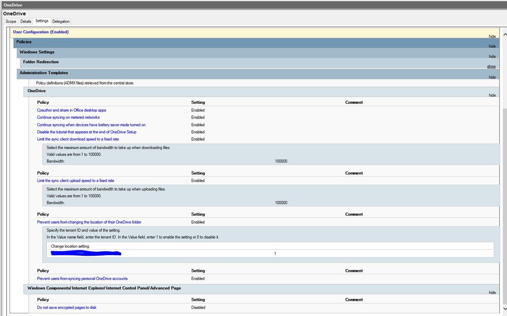

from an updated workstation, import your onedrive GPO policies to your central GPO store
Here is a copy of our GPO
then when you are ready and users are offline change the GPO for folder redirection to local user profile
additionally in AD I also have set Home folder location to : "C:\Users\%USERNAME%\OneDrive - Our College"
