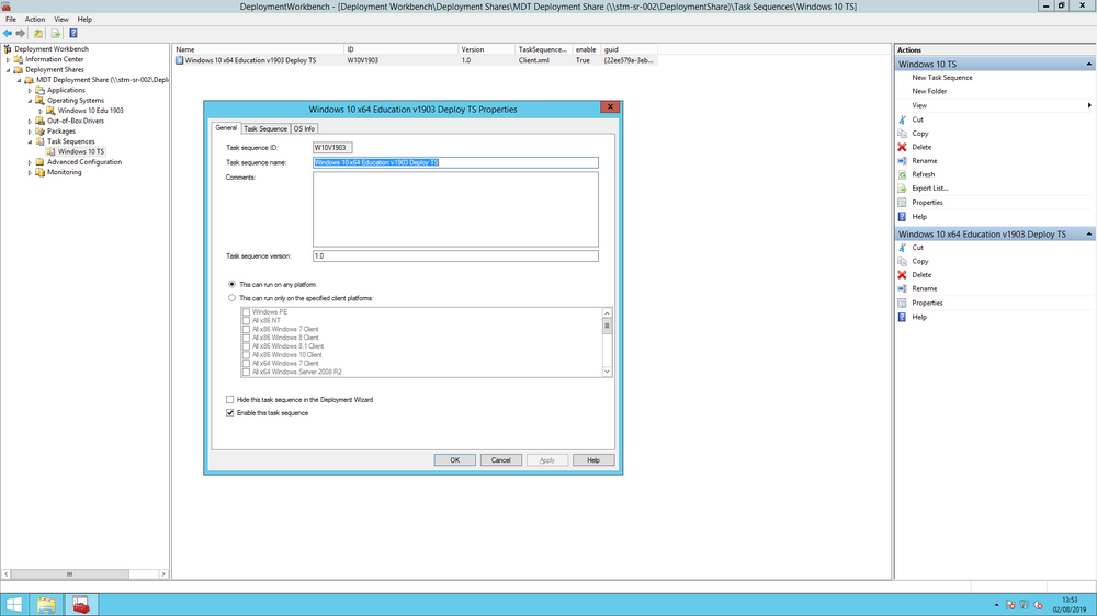

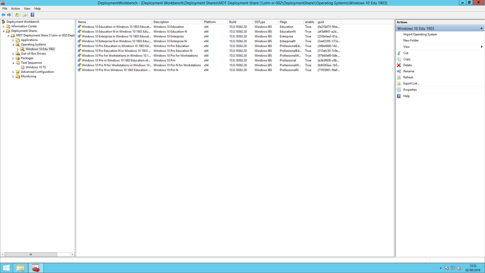

Here is my newly imported OS:
And here is the new task sequence, which should be showing but is not:
The two sequences it is showing are within the main Task Sequences folder. I have a Deploy Office sequence and an old v1809 sequence. Cannot understand why it is still not showing my new 1903. I have deleted and started from fresh as well as updated the deployment share countless times.

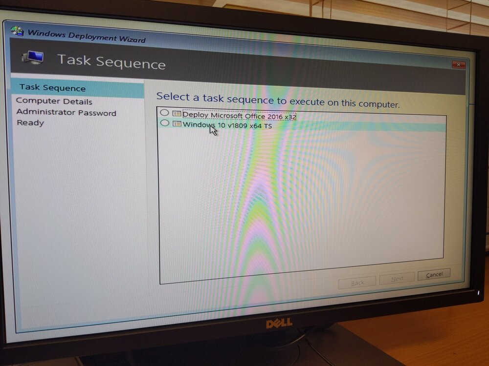

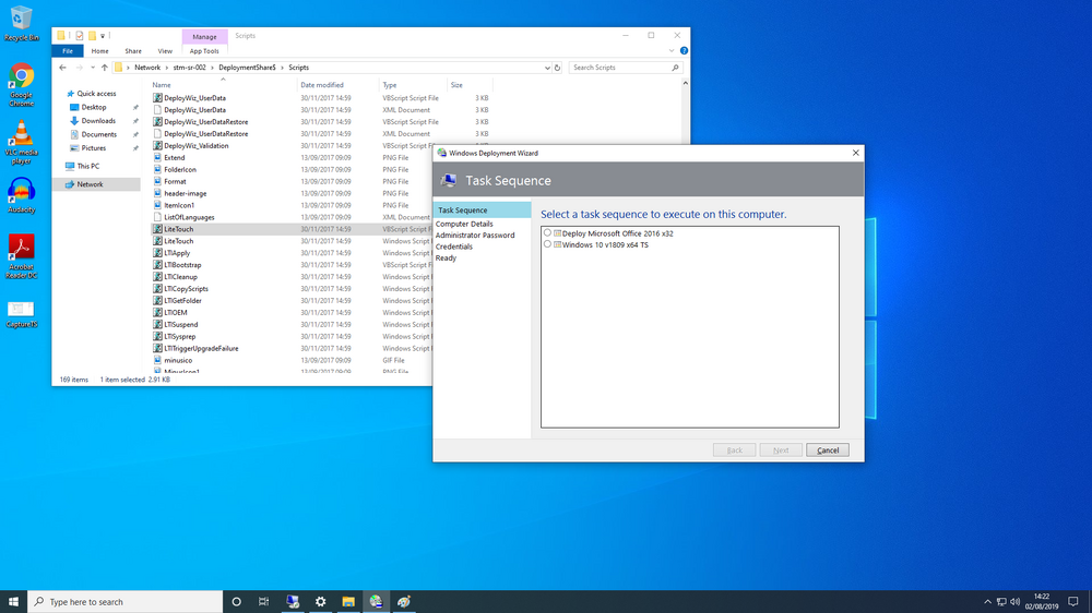

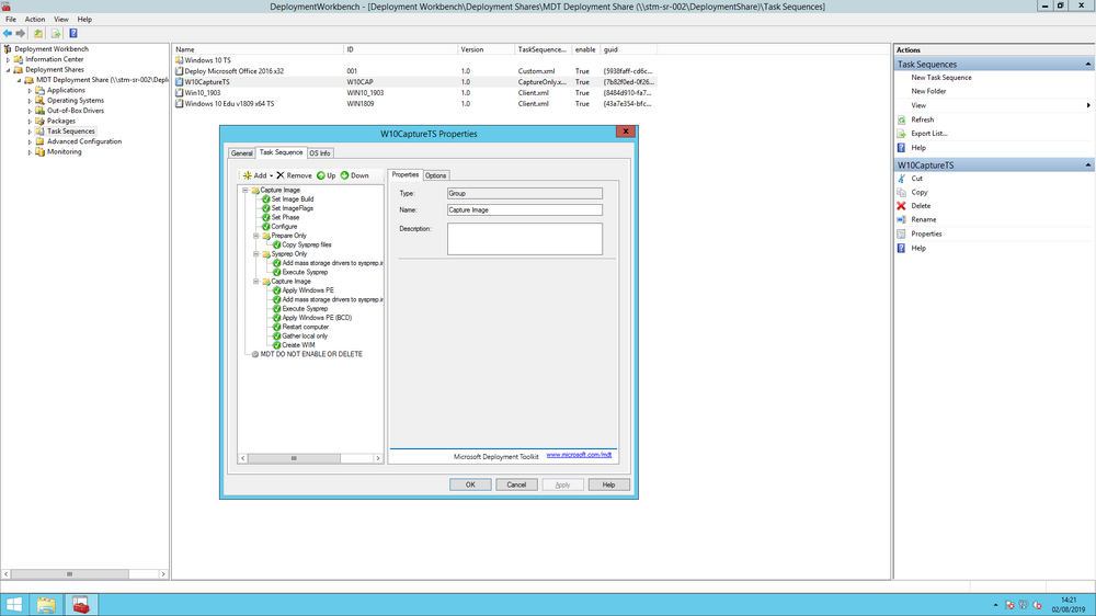

Following on from my last post, if I go through your instructions to create a Task Sequence to capture the version of Windows I have set up, I am able to add the task sequence no problem....
But when I run LiteTouch.vbs on a client system I would like to capture, as you can see, the exact same Task Sequence list is showing, and your Capture Task Sequence is not on the list.
So I am currently unable to deploy Windows 10 1903 and I am also unable to capture any version of Windows 10.
[ATTACH=CONFIG]54585[/ATTACH]
[ATTACH=CONFIG]54583[/ATTACH]

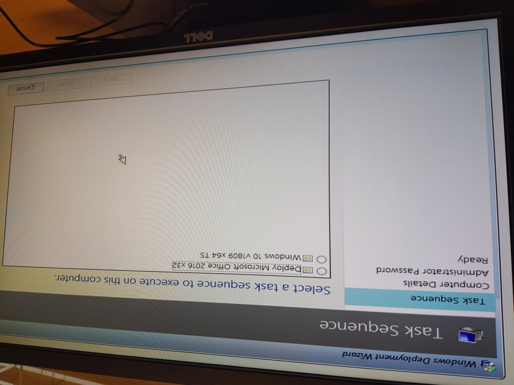

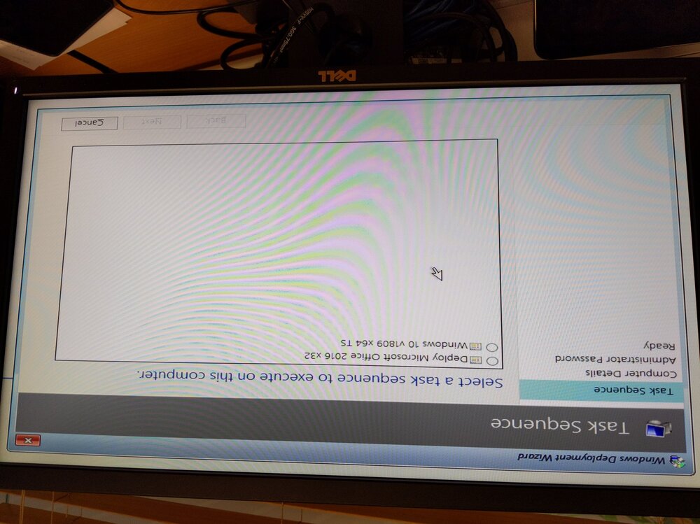

Here is what I did:
Windows Boot Manager
Selected: Lite Touch Windows PE (x64)
Microsoft Deployment Toolkit
Selected: Run the Deployment Wizard to install a new Operating System
Credentials
Entered in username, password and domain.
Task sequences are displayed. But there is no capture sequence.
As you can see, the capture task is not showing on the Task Sequence when booting from PXE boot:

Quick update, same problem. No capture is being listed. Exactly the same as before, just Deploy Office 2016 or Windows 10 v1809 x64 TS
Choose Windows 10 v1809
Ok, but that will re-install Windows 1809 again. It is not the task sequence I made to capture Windows. It is the one to install it. So I will loose all of the drivers and additional software I put on.
