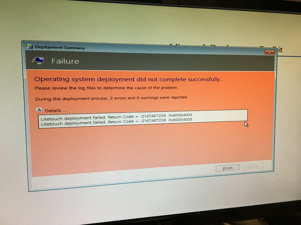

Muppet1902 Posted July 2, 2019 Posted July 2, 2019 We're trying to deploy our Windows 10 image use PXE boot, however within the last week or so we've begun getting error messages. We think it's traceable back to a power cut we had a couple of weeks ago over the weekend. Our Deployment server is 2012 R2 and we use the deployment workbench to set up the image. We get through the initial stages ok and begin the image deployment on the PC, but during the install we get an error, see attached picture. This process was set up by a recently left network manager and we're at a bit of a loss how to troubleshoot. We've tried finding the logs but have had little success, as we're not 100% where to look. So any advice, experience, ideas will gratefully received and if anyone's had the same issue in the past and can give a step by step guide how to fix, that's an added bonus, and we'll send lots of virtual chocolate as a thank you.
free780 Posted July 2, 2019 Posted July 2, 2019 Check C:\Windows\temp\deploymentlogs or X: drive. Hit F8 if your in winpe and its enabled. BDD.log is a good starting point.
strawberry Posted July 2, 2019 Posted July 2, 2019 (edited) first google search suggests changing to uefi mode. is the deploymentshare accessible? does the task sequence format the hdd properly? Edited July 2, 2019 by strawberry
