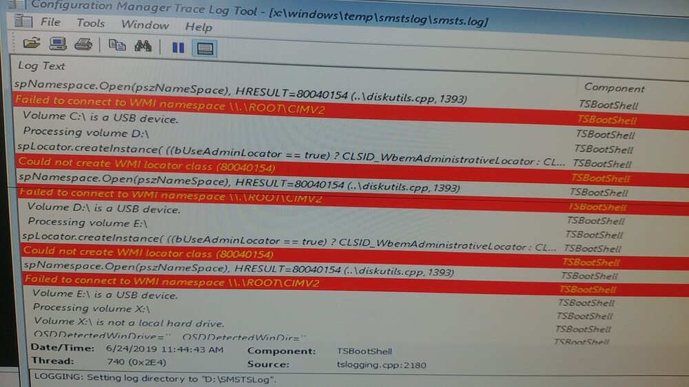

There are some network drivers in there. I have since managed to pull the logs. Done it on two devices and they're the error. Attached.
Doesn't get as far as the task sequence. Basically it was running SCCM 1810 with no problems. I updated to 1902 and now I cannot get to my password screen to even pick a task sequence. I set up a VM yesterday afternoon and booted to that. Exact same problem but without the red error entries. And as you say, it looks like it's no longer seeing an HDD...
