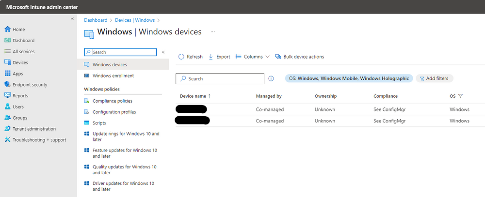

  6. Am I reading this correctly, you need the E3 or P1 paid license, won't work on the A1 Free?
  7. ahh, I have found the error of my ways. The laptop was still on our domain, and it would appear it cannot be on the domain as well as in Intune/Entra. It is now joined. Although... what I hadn't realised with the original two devices, I can only reboot, wipe, format etc. I cannot actually 'lock' the device. Is this correct if it's all done this way for free? Or does setting up SCCM correctly for Azure help in this matter?
  8. We do have SCCM setup, so I will go with that first if it involves paying nothing extra. Failing that, then if Intune is as cheap as that then we will consider it.
  9. If I do, it's on a page called InTune. Sorry, I've been a bit out of the 365 network since moving jobs to a Google school. Attached screenshot.
  10. Dear forum, Last year I managed to get two laptops enrolled into Intune MDM without having to upgrade our licensing. I'm not 100% sure how I actually managed to do it, but I did. I am now trying to do it again, but it feels like something has changed? We only have standard A1 licensing, and as a Google school we are not looking to purchase any upgrades. The limited ability I have with Google is to lock out Drive and Sign Out users on GCPW. I think I just signed into the laptop as admin, then added my work account and allowed the Device Management, I also got to this via another settings window which looked familiar, but it denies MDM due to a missing license. Do I now need to purchase something InTune, or is there a free work around so I have the power to lock and wipe Windows devices?
