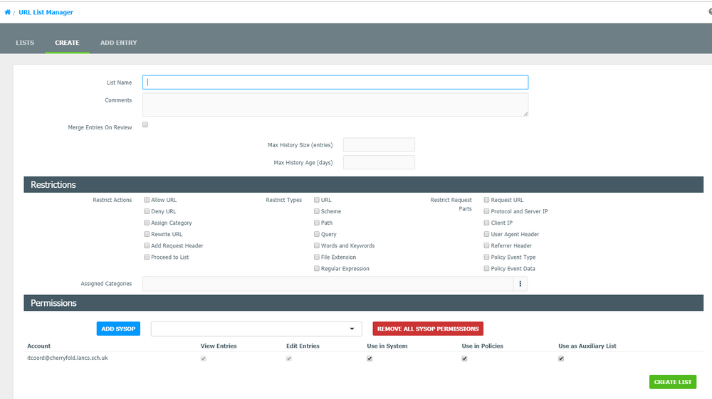

What I've done is go into URL Tools > URL List Manager. In there I have created a lists called Student Allowed / Student Blocked. Click create list then check the box for either a Deny or Allow list,
Then you add the URLs into that list to allow or block.
Hope that helps. Give me a shout if you need more deets.
