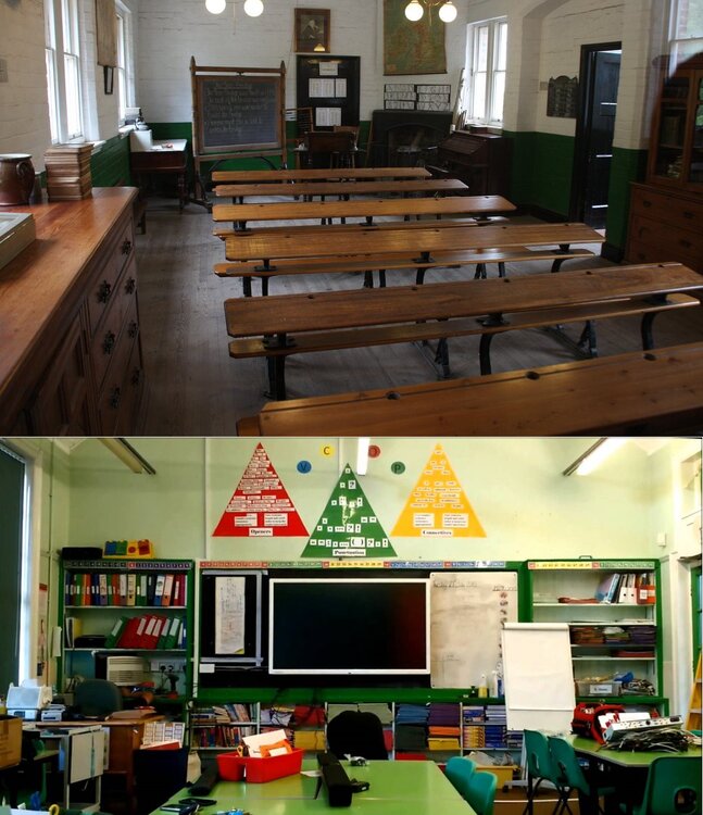

Looking at it from the wrong perspective. A portable interactive tablet, iPad, Chromebook, MS Surface device for the teacher means they are no longer tethered to the front of the screen. So much more flexibility for the teacher to engage with their pupils and enhance teaching.
Spot the difference.
Mavhc has said the tablet would be connected via USB - so still tethered.
What you're suggesting is wireless casting, not what the OP is looking to do.
And I hardly feel the picture is a fair comparison!
