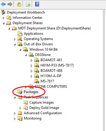

Could you not just slipstream the most recent cumulative updates by importing the files from Microsoft's Update Catalog website into the applications/patches folder called during the MDT task sequence?
Do you mean adding the updates here?
I've not tried this method before....
