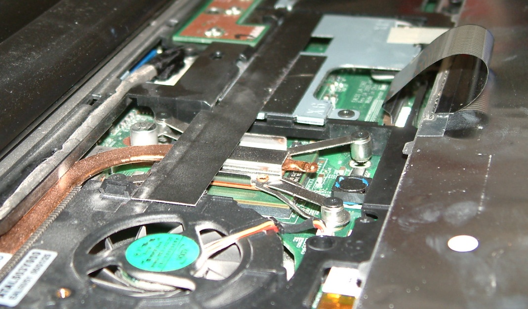

Attached is a photo of the fault. If you look closely at the four fixings that hold down the heatsink on the CPU, you'll see that the furthest two have lifted out of the main board. This leads to overheating and shutting down of the machine.
We found others with only one post out of the main board, these work fine for now, but will almost certainly fail in due course.

If not, or if you just fancy having a go at repair yourself, get some epoxy putty. Remove the cpu, unscrew the mounts, and use the epoxy to firmly secure the mounts to the board from top and bottom being careful with surrounding electrical contacts. Give it 15 minutes to dry (it'll be rock hard within 2 but best do a proper job) and you'll be able to re-mount the heatsink correctly. Perhaps use the epoxy to secure mounts that haven't come away yet as a security measure. It'll be cheap and will outlast the life of the laptop.

I had same problem as well, took me ages to track it down but the good news is it can be really easily fixed with superglue - just glue the metal stub back into the motherboard. Also need reapply thermal paste to the processor for it to work 100% though not essential first time around. I have had to do it a couple of times more, once when I stepped on the computer, the next after I, and the computer, came off a motorbike, so in other respects it is a pretty robust machine. I think it happens in the first place from the computer flexing when you use it on your knees, but it is a laptop.
