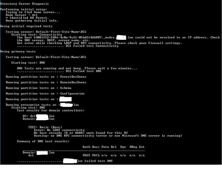

Here are the results of the dcdiag /test:dns
(performed using the 192.168.1.20 as the Preferred DNS server, not the 127.0.0.1 that JackCPickup said to try)
Edited by toffee_paul
