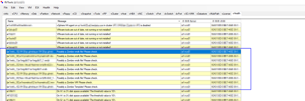

For hunting Zombies, I strongly suggest you download RVTools - https://www.robware.net/rvtools/ and connect to your VCentre or host if you just have 1 and look at the vHealth tab in that and it shows suspected Zombies as follows:
Be warned if the LUNS are shared with other hosts that RVtools cannot see, for example if you use VMware without a vCentre server so connect to an individual host, or you use VVOls you may find more marked than you expect so double check before you go deleting anything, should your LUNS be exclusive for the host(s) and if you have vCentre and go via it you should be safe to delete what it says are Zombies.
RVtools is free so anyone using VMware should have it on your PC its a great thing and shows more than Zombies.
