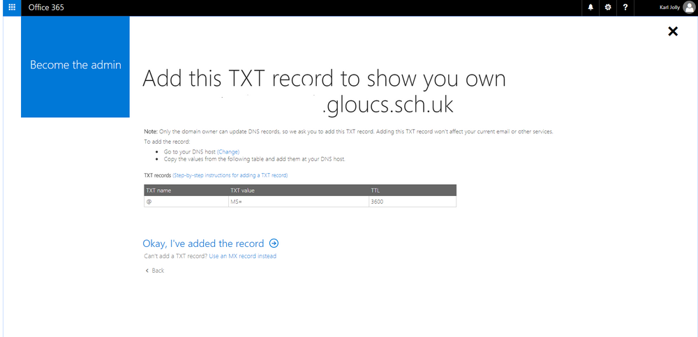

This is the part where you need RM to add a record to your external DNS so MS know you own it. You will also need to add records to your external DNS which points Azure back at your domain, this comes later. Otherwise, they have no idea where to look to query your AD.

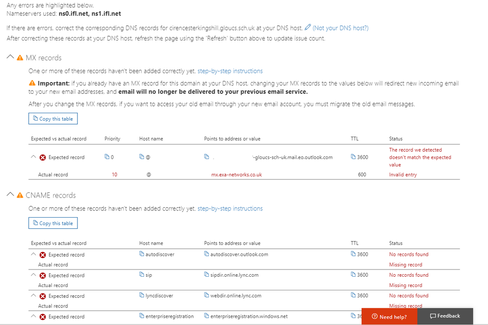

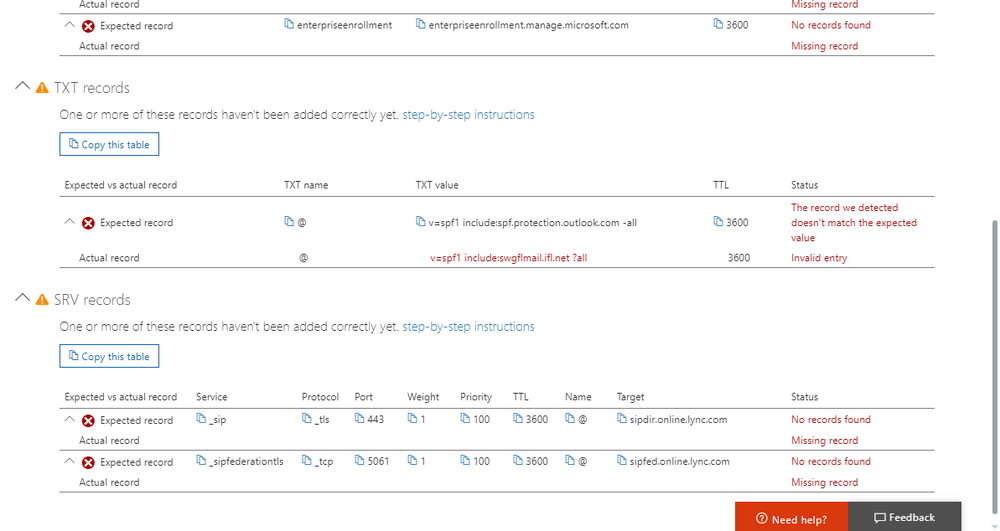

Do you know which one i need them to add? I did the one to verify the office 365 against our domain. Also i don't want to break our onsite exchange.
Don't change your MX record - that's the big one for mail delivery. Then you need to carry on with the Step 1 process for domain verification. If that can't complete, the entry in DNS hasn't been done correctly, or hasn't yet propagated.

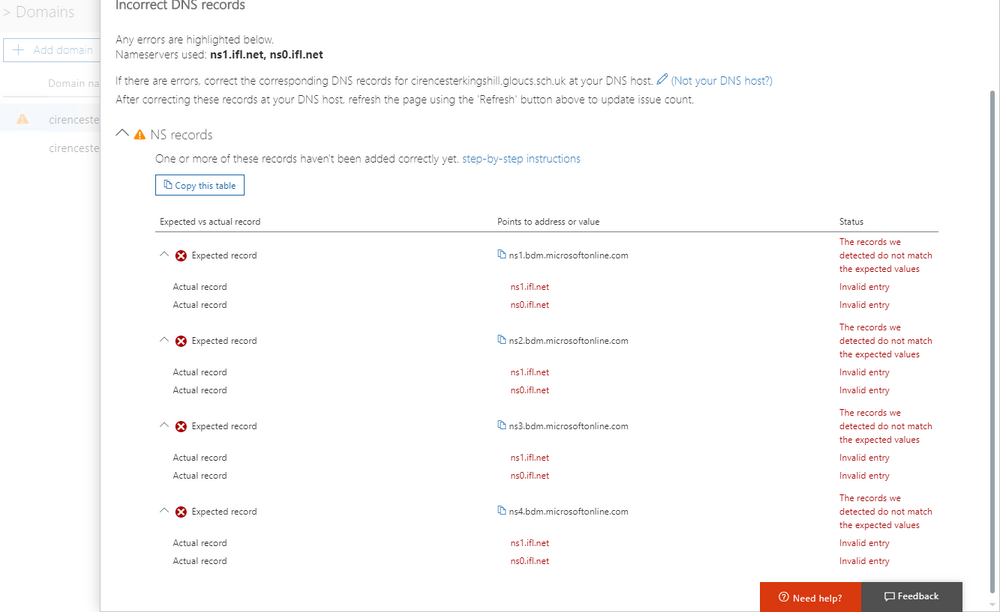

Which one (or many) of these do i need to RM?
