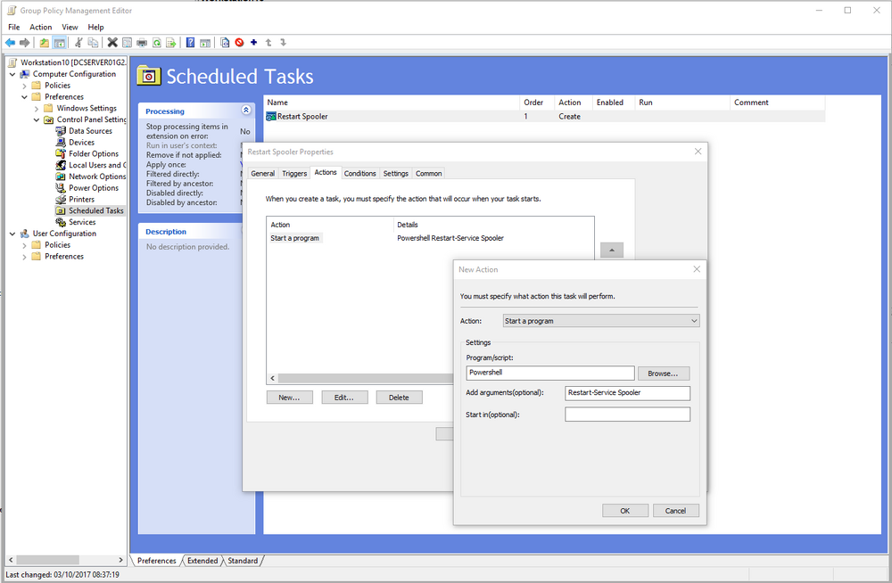

I've set a delayed at logon to restart the print spooler which has helped, not solved it but has at least made it only happen on the odd machine wi. Interesting the correlation with clearing local profiles after x days (we use this setting) Keep up the research guys.
Hey Robert in my windows environment when I first build a machine and join to domain I get event 513 but logout and back in and it’s fine. I like your idea to have a delayed print spoiler restart and wondered if that was a computer or user gpo ? Maybe you’ve got a screen shot?
Thanks
John
Nice way - I did it in the end running as system with script in netlogon. However I prefer your way so will change it, as it doesn’t have a dependency on the server
