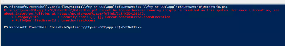

And I get the following error o the ISE:
PS Microsoft.PowerShell.Core\FileSystem::\\fty-sr-001\applic$\DotNetFix> \\fty-sr-001\applic$\DotNetFix\DotNetFix.ps1
File \\fty-sr-001\applic$\DotNetFix\DotNetFix.ps1 cannot be loaded because running scripts is disabled on
this system. For more information, see about_Execution_Policies at
https:/go.microsoft.com/fwlink/?LinkID=135170.
+ CategoryInfo : SecurityError: (:) [], ParentContainsErrorRecordException
+ FullyQualifiedErrorId : UnauthorizedAccess
I have tried restarting the machine to see if it worked, but no, same as before, it has not gone on.

Thanks, I must have missed that earlier. :) Have made the changes, but still getting the same error again:

Looks like you have unsigned powershell scripts disabled... from a command prompt (yes, command prompt) type:
powershell.exe –ExecutionPolicy Bypass "\\fty-sr-001\applic$\DotNetFix\DotNetFix.ps1"
IIRC... Startup powershell scripts in GPOs will run regardless.
Thanks, that has worked perfectly on my test machine and now Kinovea works on my test computer.
