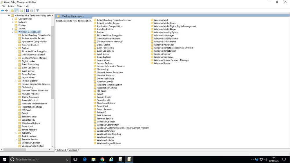

Unable able to find that here.
Running Windows 10Edu 1703.
Any ideas?
[ATTACH=CONFIG]46056[/ATTACH]
Are you using the latest Group Policy files - have you download/installed the 1703 (or now 1709) .ADMX files?
