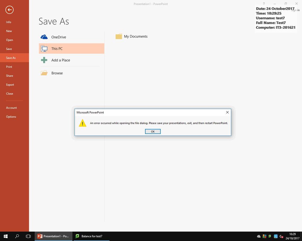

just started work in a secondary school and the have the following problem.
When saving a Powerpoint document to a redirected student folder we get the following error saveissue.jpg
This only happens when the document has data in it. For example if login with a student ID and the open PowerPoint straight away and immediately save an empty powerpoint the issue goes away completely.
Whatever we do on a powerpoint document that has not been saved as a empty document first becomes impossible to save in anyway.

Saving to a local drive is impossible .. saving anywhere is not possible.
Share permissions are OK (I think) as we can same an empty powerpoint at fist login and also create a text file at any time is the redirected folders.
Accounts that work are for sure are any roaming profiles.
So .. at the moment we are looking at profiles ... for no particular reason other that narrowing down the issue.
