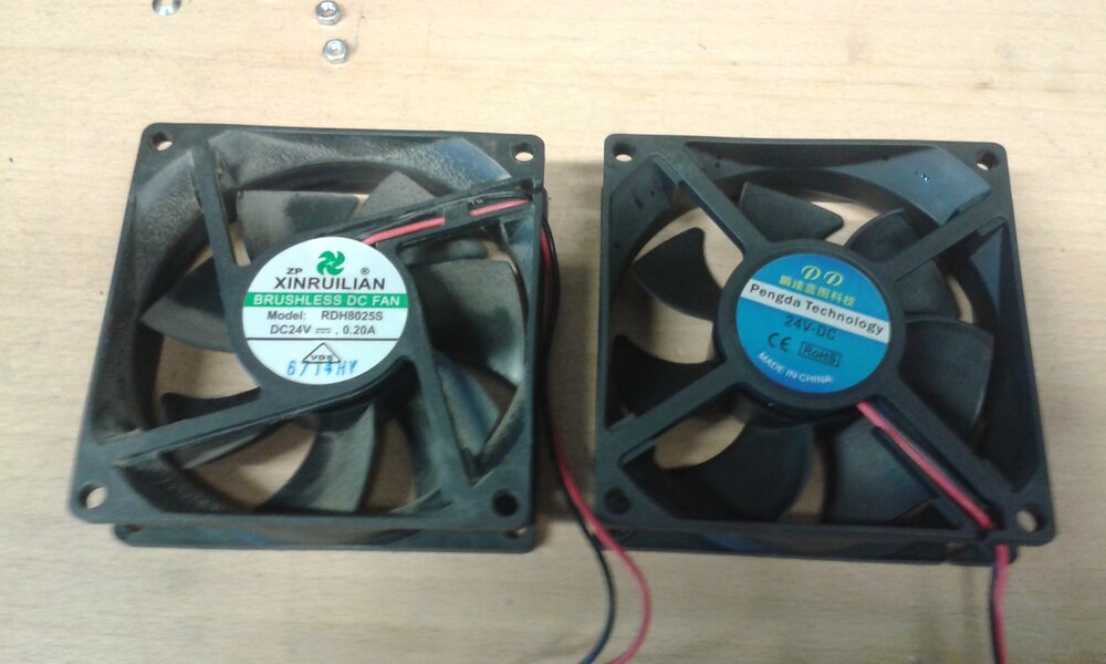

Photos of the stickers on the fans might help identify the difference.

I've put the old fan back in and returned the amp to use for the moment. Here are the two fans though, neither have much in the way of identifying marks! Old on the left, new on the right.
