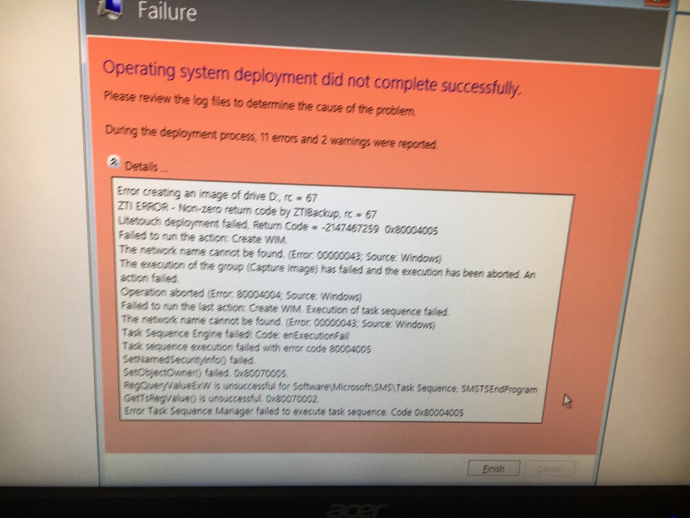

Got the PC to complete sysprep portion, however upon reboot and attempt to capture, I get the below error. I tried to re-do the permissions on the share, to no avail. Any other ideas?

I don't get prompted for credentials if I use the net use command to connect to the deployment share. It connects to the share while in Windows, but after reboot and when it starts to create the WIM is when it crashes out. I did upgrade to build 8443 yesterday when I saw that could potentially cause a problem. I even created the TS on my old share and tried it there - I got the same error at the same point. Is there another way of capturing the WIM or does someone know how I can contact someone at MS and get some support?
