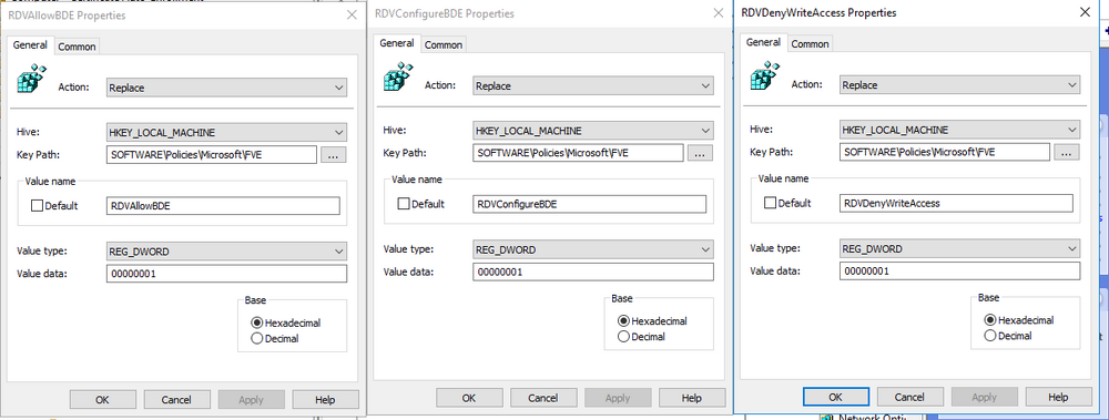

gshaw Posted February 13, 2017 Report Posted February 13, 2017 (edited) @FN-GM click to enlarge Each one has an item-level targeting setting applied so the BitLocker only gets enabled for a specified group. So effectively a per-User GPO sets HKLM level policies via the GPP. Edited February 13, 2017 by gshaw 1
FN-GM Posted February 13, 2017 Author Report Posted February 13, 2017 Just to confirm 0 is off and 1 is on? What client OS are you using? I have attach my polices. I want to make the drives read only until you encrypt. The user also gets prompted to encrypt. Do they look ok please? I can't see why it doesn't work, so thinking it might be me!!

mdrabble Posted November 28, 2017 Report Posted November 28, 2017 (edited) Just gone over the guide and I'm getting nothing..... no prompt or denied access. Instead of using the group method, I am currently testing on a test user - so the user targeting is for a user and not member of group. Apart from the 3 registry entries to set the attributes, is there anything else I need to do? - I take it these are placed under the User GPP and not Computer GPP Edited November 28, 2017 by mdrabble

mdrabble Posted December 5, 2017 Report Posted December 5, 2017 @gshaw just noticed one of your registry enteries is for HKLM\System\CurrentControlSet Which is covered on the weblink at the top of the page - could you let me know what the full entry is for that key please. I suspect that may be why my attempt isnt working as I put the last entry under the same location as the others. Cheers
gshaw Posted December 5, 2017 Report Posted December 5, 2017 @MRDabble here you go, straight export from my GPP page That will enable BitLocker for the user it's applied to Name Order Action Hive Key Value Name Type Value Data RDVAllowBDE 3 Update HKEY_LOCAL_MACHINE SOFTWARE\Policies\Microsoft\FVE RDVAllowBDE REG_DWORD 00000001 RDVAllowBDE 4 Update HKEY_LOCAL_MACHINE SOFTWARE\Policies\Microsoft\FVE RDVAllowBDE REG_DWORD 00000000 RDVConfigureBDE 1 Update HKEY_LOCAL_MACHINE SOFTWARE\Policies\Microsoft\FVE RDVConfigureBDE REG_DWORD 00000001 RDVConfigureBDE 2 Update HKEY_LOCAL_MACHINE SOFTWARE\Policies\Microsoft\FVE RDVConfigureBDE REG_DWORD 00000000 RDVDenyCrossOrg 5 Update HKEY_LOCAL_MACHINE SOFTWARE\Policies\Microsoft\FVE RDVDenyCrossOrg REG_DWORD 00000001 RDVDenyCrossOrg 6 Update HKEY_LOCAL_MACHINE SOFTWARE\Policies\Microsoft\FVE RDVDenyCrossOrg REG_DWORD 00000000 RDVDenyWriteAccess 7 Update HKEY_LOCAL_MACHINE SYSTEM\CurrentControlSet\Policies\Microsoft\FVE RDVDenyWriteAccess REG_DWORD 00000001 RDVDenyWriteAccess 8 Update HKEY_LOCAL_MACHINE SYSTEM\CurrentControlSet\Policies\Microsoft\FVE RDVDenyWriteAccess REG_DWORD 00000000 2
mdrabble Posted December 5, 2017 Report Posted December 5, 2017 Now working! - It was the very last entry that was the issue. Once added it now prompts as excepted. @FN-GM This now works for me - looks like we didn't have the last registry key in the correct place - we had it under HKLM\SOFTWARE\Policies\Microsoft\FVE instead of HKLM\SYSTEM\CurrentControlSet\Policies\Microsoft\FVE 1

eddyc Posted April 26, 2018 Report Posted April 26, 2018 Sorry to drag up an old thread. @gshaw I have just tried your GPO preferences as per below but am not getting any prompts after a GPupdate. We are using Windows 10 x64 1709 Education. Is there a feature that needs to be enabled to make this work? Cheers, Eddyc @MRDabble here you go, straight export from my GPP page That will enable BitLocker for the user it's applied to Name Order Action Hive Key Value Name Type Value Data RDVAllowBDE 3 Update HKEY_LOCAL_MACHINE SOFTWARE\Policies\Microsoft\FVE RDVAllowBDE REG_DWORD 00000001 RDVAllowBDE 4 Update HKEY_LOCAL_MACHINE SOFTWARE\Policies\Microsoft\FVE RDVAllowBDE REG_DWORD 00000000 RDVConfigureBDE 1 Update HKEY_LOCAL_MACHINE SOFTWARE\Policies\Microsoft\FVE RDVConfigureBDE REG_DWORD 00000001 RDVConfigureBDE 2 Update HKEY_LOCAL_MACHINE SOFTWARE\Policies\Microsoft\FVE RDVConfigureBDE REG_DWORD 00000000 RDVDenyCrossOrg 5 Update HKEY_LOCAL_MACHINE SOFTWARE\Policies\Microsoft\FVE RDVDenyCrossOrg REG_DWORD 00000001 RDVDenyCrossOrg 6 Update HKEY_LOCAL_MACHINE SOFTWARE\Policies\Microsoft\FVE RDVDenyCrossOrg REG_DWORD 00000000 RDVDenyWriteAccess 7 Update HKEY_LOCAL_MACHINE SYSTEM\CurrentControlSet\Policies\Microsoft\FVE RDVDenyWriteAccess REG_DWORD 00000001 RDVDenyWriteAccess 8 Update HKEY_LOCAL_MACHINE SYSTEM\CurrentControlSet\Policies\Microsoft\FVE RDVDenyWriteAccess REG_DWORD 00000000
mdrabble Posted April 26, 2018 Report Posted April 26, 2018 @eddyc this works fine on 1709 Have you made sure the RVDenyWriteAccess is under SYSTEM\CurrentControlSet\Policies\Microsoft\FVE
eddyc Posted April 26, 2018 Report Posted April 26, 2018 Hey, thanks for the reply. Yes I have. Do I need MBAM installed too or should this work natively with just the OS? @eddyc this works fine on 1709 Have you made sure the RVDenyWriteAccess is under SYSTEM\CurrentControlSet\Policies\Microsoft\FVE
mdrabble Posted April 27, 2018 Report Posted April 27, 2018 I've not looked at MBAM - I supposed I should do if that is the correct support method..... Mine works directly from GPO using registry settings and Item-Level Targetting to apply/remove the registry settings.
eddyc Posted April 29, 2018 Report Posted April 29, 2018 I must be missing something then, sadly I do not get any prompts or anything despite copying those GPP to the letter! :-( I've not looked at MBAM - I supposed I should do if that is the correct support method..... Mine works directly from GPO using registry settings and Item-Level Targetting to apply/remove the registry settings.
