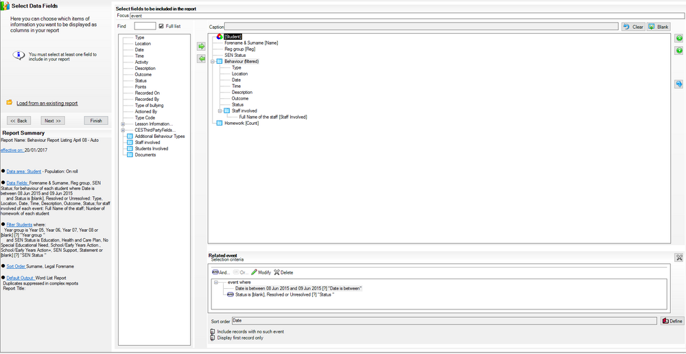

I am trying to get commandreporter to run, exporting a file. This is the report:
And this is my Powershell script to run commandreporter:

My issue is this - it is ignoring my date entries. I have confirmed that the string is actually generating with the right date, but the output file has used the dates that were in the fields when the report was created.
What am I doing wrong here? I've tried doing it by exporting the params to a file instead, but that does the same thing.
