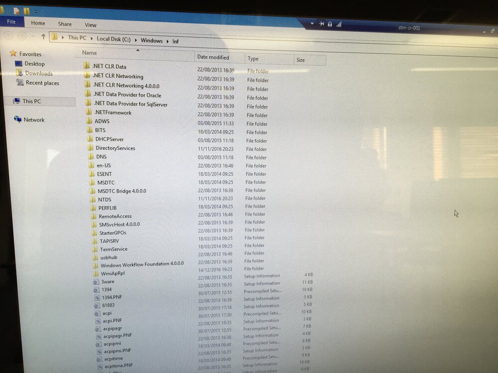

Thanks very much. The 2016 ones is not a bad idea. This is what I currently have:
Presumable, I extract the templates and put them in this location?
Nope. They need to go in C:\Windows\SYSVOL\sysvol\domain.com\Policies\PolicyDefinitions
If that doesn't exist, create it first. This assumes that your sysvol folder in C:\Windows is called SYSVOL - it may not be in some cases. Otherwise go to \\domain.com\SYSVOL\domain.com\Policies\PolicyDefinitions
Thank you both, silly that MS don't just have it auto extract, but maybe it would overwrite things people had already done. Either way, it looks like that has done the job!
