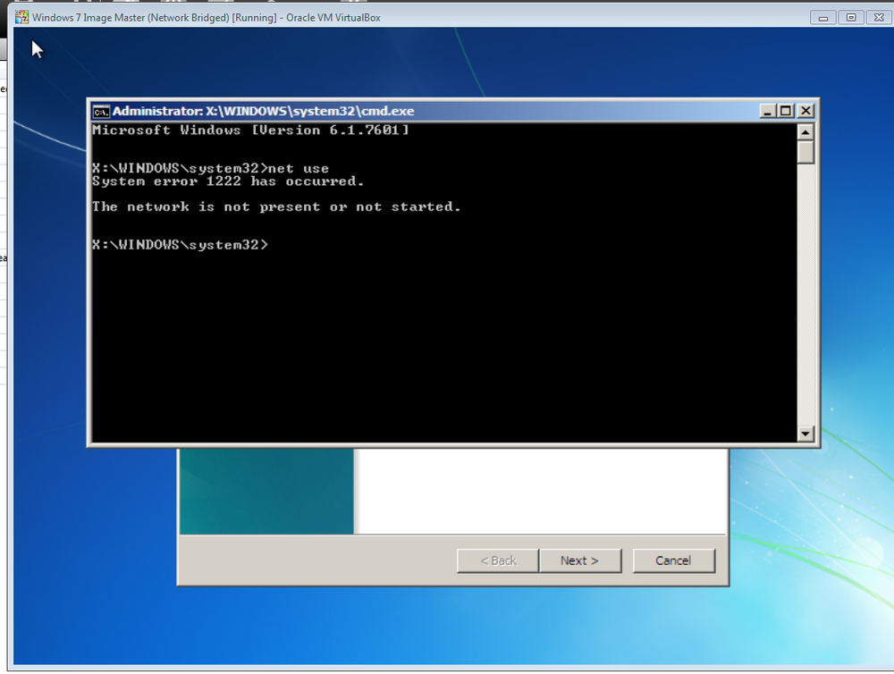

marsdenprimary Posted November 11, 2016 Author Posted November 11, 2016 I'm getting a System error 1222 saying the network is not present or not started now... Any ideas??
marsdenprimary Posted November 11, 2016 Author Posted November 11, 2016 What did you change? Steve I've not changed anything... it's really bizarre. It let's me connect to the WDS server no problem but the CMD in DOS is throwing this at me now...I might be doing it wrong though.
Steve21 Posted November 11, 2016 Posted November 11, 2016 Can you screenshot what it's saying? (or type it if you can't screenie), just so many ways to do it not sure what commands you mean Thanks, Steve 1
marsdenprimary Posted November 14, 2016 Author Posted November 14, 2016 Can you screenshot what it's saying? (or type it if you can't screenie), just so many ways to do it not sure what commands you mean Thanks, Steve Sorry for the delay here we go:
