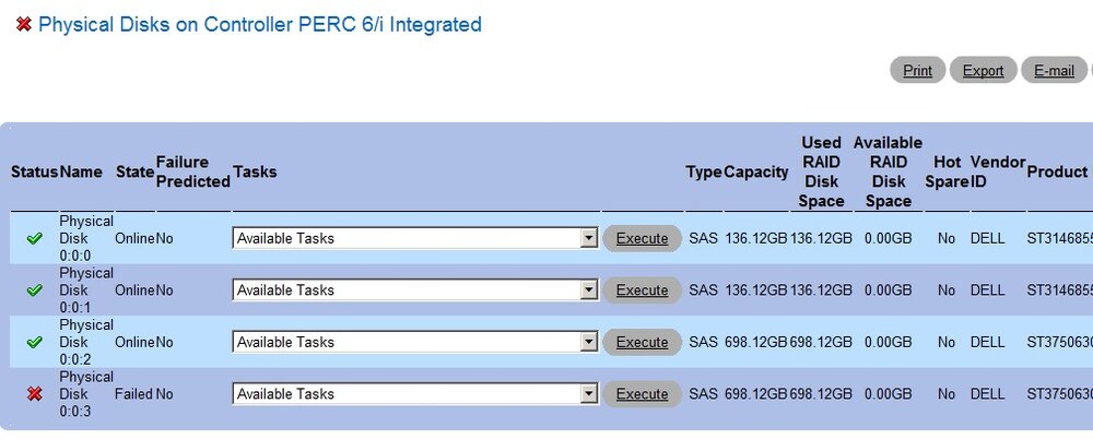

We had a failed disk on a RAID 5 setup on a Dell PowerEdge 2900III
Replaced the Disk last night and all looked good, monitored in Dell OpenManage Administrator and the RAID / Disk showed to be Rebuilding.
However I have woken up this morning to find the new disk is Offline and a second disk has failed.
I've had a string of emails from Sophos complaining it cannot read certain files - otherwise all seems ok - accessing file wise.
I know I need to replace the failed Disk asap but not sure what to do about the Offline new replacement Disk - do I wait until the failed disk is replaced too?
In Dell OpenManage Administrator I can click to make the Offline disk Online, however I have this warning;
Warning: Making a physical disk online does not verify the virtual disk's parity or data. If data was written to the virtual disk while the physical disk was failed, then making the failed physical disk online may result in data loss. It is strongly suggested that you either allow an automatic rebuild of the physical disk to complete or initiate a check consistency of the virtual disk after the Online task completes. Are you sure you want to make this physical disk online?
Will I lose data - I'm a little nervous to try it!
Some screenshots from Dell OpenManage Administrator;
We do have a backup of all data that may have been lost but the thought of needing to recover using that doesn't appeal - but it's good to know it's there!
Thanks, Ben

to me that looks like you have a failed drive in 2 different arrays, which make up you Virtual disk 1 & 2.
if a disk has failed and you pull the failed one and replace it it *should* start an auto rebuild. pulling the correct disks is key (if you have hot swap caddies you should have solid amber lights iirc)
on the server can you still see the files?
sophos / file access might be because its slow to repsond as the array (if it is still workings is in degraded mode and will be much slower)
Take a deep breath and make the replaced drive online and see what happens.
Then if all is well, replace the other failed drive.

Ok, so having re-read the warning I took the plunge and made the new drive online - amazingly luck was on our side and it worked.
Files were missing beforehand - I thought having lost 2 disks from a RADI5 all access would be gone, but some were still available.
The new drive is now online and I only have one fault - one failed disk - so the RAID is fully operational again.
