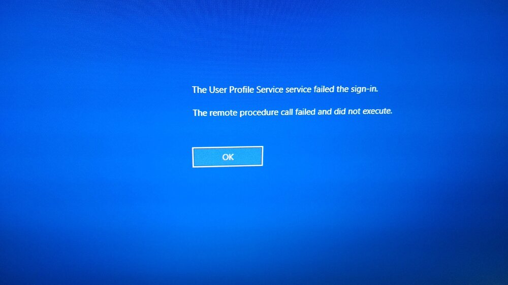

FragglePete Posted August 24, 2016 Posted August 24, 2016 Just coming up to the last few machines left to deploy 1607 too - largely gone ok but a few little issues which we will just have to deal with as and when. One that has me a little puzzled is when I sometimes go to log onto a random machine, I get the following error: The User Profile Service service failed the sign-in. The remote procedure call failed and did not execute. See the picky: I hit ok, and try logging in again and all seems well again. Got me scratching my head a bit this has...... going to do a few checks on AD and DNS just to make sure everything is well, but most puzzling! Any ideas? Pete

disk Posted August 24, 2016 Posted August 24, 2016 (edited) Are you running Visual Studio 2015 per chance? We experienced the same error (on Windows 8.1 and 10) after deploying VS2015 through SCCM along with Windows. It appears as though it enters some files into the Default User profile (appdata->roaming) because there hasn't been another user profile created and the way the installer works. We deleted the Microsoft folder found under appdata/roaming and it fixed the Default User profile which then allowed all other users to properly sign in. That was our experience any way. *edit* The Microsoft folder that we removed to correct the sign on issue was in AppData/Local, not roaming. Edited August 24, 2016 by disk 1

ITGuyWestMidlands Posted August 24, 2016 Posted August 24, 2016 What type of profiles are you using? Local, roaming, mandatory?
FragglePete Posted August 24, 2016 Author Posted August 24, 2016 I've noticed over the last couple days all sorts of weirdness - and from what is written here and elsewhere it would appear it's not me but this dodgy build! So, relieved in a way but now annoyed that some 550 devices deployed now have to be looked at again before the term starts. I've been getting these 'User Profile Service' errors, bad stub errors when clicking on Start Menu items, Windows updates appearing to get stuck and on occasions stuck on 'preparing windows' on logon. Grrrr.... so annoyed. Still, .msu added to MDT for the handful of machines we have left. Using BCX Tools so can initiate a package task on the domain that installs this update (tested remotely and appears to work well) - just need to get everything fired up over the next few days and get the update installed. Hopefully this will settle things down abit. Just to add; I'm using Redirected Folders - not using profiles. Pete
mullet_man Posted August 24, 2016 Posted August 24, 2016 Am using local profiles with redirected start menu. Thanks FragglePete, like you say glad it's not just me with the same issues. One of the new updates was a servicing update so hopefully that will fix the issue. I haven't deployed it no where near as many devices but like you say it's a dodgy build indeed, at first I thought my reference image was messed up. You need to make sure you add the two new KBs to MDT the cumulative update and the servicing update for the windows update step to work so am guessing the WSUS issue is fixed by one of those kbs. 1

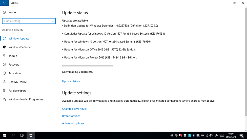

mullet_man Posted August 30, 2016 Posted August 30, 2016 I've made adjustment to my GPO that changes the delivery optimisation setting to Bypass. So far I haven't found it any better, the updates are getting stuck at 0%, then download, then disappear, then re-download but don't seem to install. How long does it normally take? Hopefully as per your post, the updates will eventually download. I've been back in today, and have successfully imaged two IT rooms, both imaged fine and updates ran during the MDT TS. I then ran 3 more devices which needed imaging only to find they got stuck as per the original issue. It's been one big massive cock, I waited a year to start my Windows 10 deployment in the hope all the issues would be ironed out by then but it's been a disaster. Am glad at the minute it's only going to be a phased rollout to our newer machines. Thanks for keeping us updated, the big irony is the line about clients not being able to download cumulative updates will be fixed in a future cumulative update.
FN-GM Posted August 30, 2016 Posted August 30, 2016 I am having this issue on odd machines, we use local profiles on LTSB 2015. Only fix I have found is deleting the profiles on the machine.
FragglePete Posted August 30, 2016 Author Posted August 30, 2016 We're getting the odd machine that seems to get stuck pulling down the updates even after these latest KBs have been applied. Usually just leaving the thing alone and trying later seems to work. Pete
mullet_man Posted August 31, 2016 Posted August 31, 2016 We're getting the odd machine that seems to get stuck pulling down the updates even after these latest KBs have been applied. Usually just leaving the thing alone and trying later seems to work. Pete As a test am going to leave this laptop on and see if it updates, been on now for a good 10 mins. How long does it taken normally?
FragglePete Posted August 31, 2016 Author Posted August 31, 2016 [ATTACH=CONFIG]38498[/ATTACH] As a test am going to leave this laptop on and see if it updates, been on now for a good 10 mins. How long does it taken normally? Some machines not very long, others it's taken over a day!!!!! Pete
ITGuyWestMidlands Posted August 31, 2016 Posted August 31, 2016 (edited) As a quick fix you could try adding your users to the donain guests group as these should get deleted off at log off. I holding back on windows 10 for another 6 months at least, can be doing with out these headaches atm. Edited August 31, 2016 by ITGuyWestMidlands
