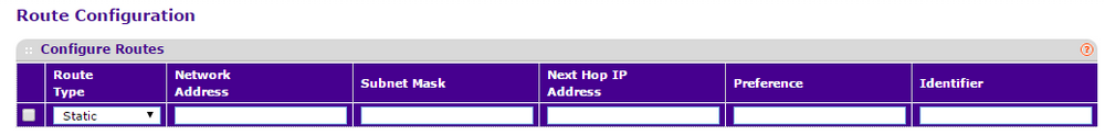

This is the Routing table from my core:
The "Learned Routes" at the bottom are the VLANs subnets and the "Next Hop Address" is the router's address and the gateway for the subnet.
I have static routes for any traffic that goes to our other site, which you can ignore, but also in the "Static Routes" tab, at the top, is the default route, which means; anything that the router doesn't know about goes to this address (in my case, the firewall/gateway).
Once you've added the addresses to the VLANs here:
they are automatically added to the Learned Routes table (above).
The routing table is what tells the router where everything is. As it knows where all the subnets are and what the IP ranges are for each, it knows that for a client on VLAN 170 sending packets to the servers on VLAN 10, the packets need to be routed between the 2 subnets.

Although i have ran into another problem, i've just attempted to put in a static route to the router and i get the following message;
Error! The specified Static Route Next Hope Router Address can't be in the same subnet as the service/network port.
Any idea what the service/network port is?
