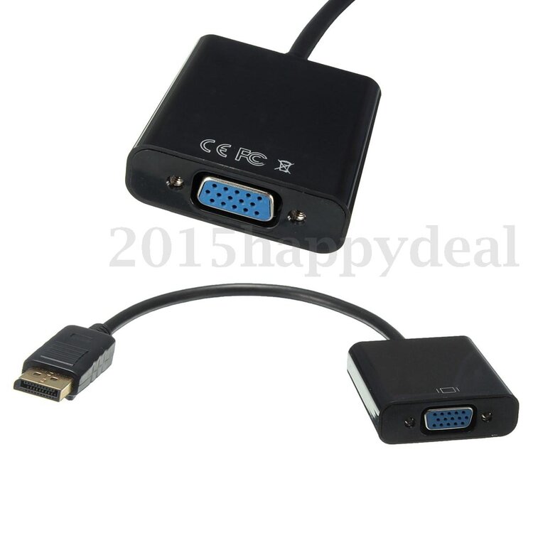

I'd personally get two DVI-VGA adapters for the normal VGA monitors and then a HDMI/Display Port to DVI adapter for your current monitor.
At least that way you can retain one Digital rather than all analogue displays.

@Arthur's got it. Top DVI is digital only (notice the absence of 4 pins around the flat pin). Bottom DVI is analogue too, so you could use a DVI-VGA cable on that. That'd leave you with 1 HDMI-VGA converter left to buy.
