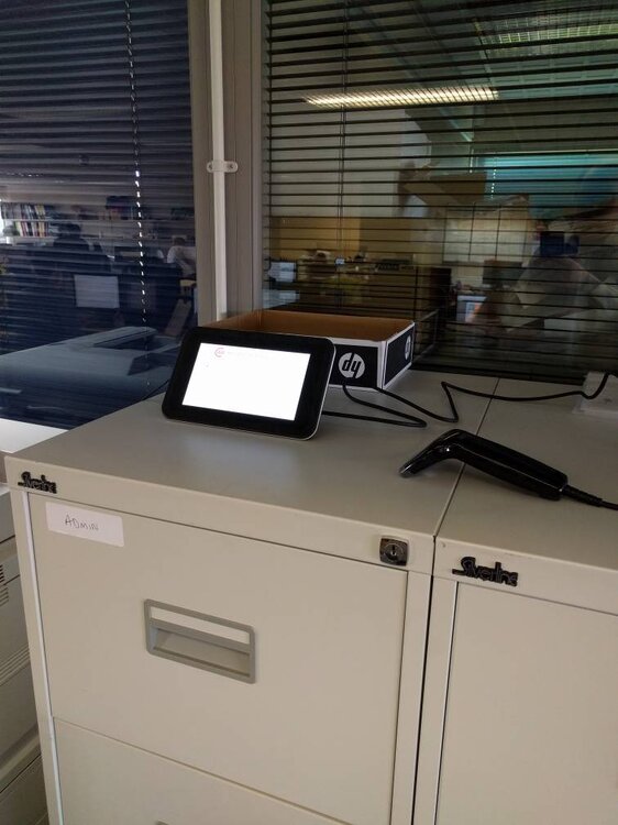

CAWJames Posted June 7, 2016 Posted June 7, 2016 Just rolled out 8 of these bad boys, RPi3 fully wireless barcode scanning release stations. Fair to say the populace loathe me now until they see the benefits that is!
sted Posted June 7, 2016 Posted June 7, 2016 Just rolled out 8 of these bad boys, RPi3 fully wireless barcode scanning release stations. Fair to say the populace loathe me now until they see the benefits that is! looks useful i guess the barcode scanner is so staff can scan a card to release their print jobs?
CAWJames Posted June 7, 2016 Author Posted June 7, 2016 Yes, when we issued badges starting a couple of years ago, we added their 6 digit database number as a barcode for "future use", read filling space on the card. So staff print to a pool printer, rock up to a photocopier and scan their staff badge, printing can then be released Obviously if we had smart cards, we could add a USB reader for whatever type they would be, as long as it gets the number to the login field. 1

CAWJames Posted June 7, 2016 Author Posted June 7, 2016 Ah ok, well you need: Print release licence from PaperCut A Raspberry Pi, I am using 3's with built in wifi, but a 2 will do the same with a dongle or patch cable Touch screen compatible with above, I am using the official touch screen and a all in one case from CPC/Farnell A keypad, keyboard scanner, usb or gpio or whatever way you need to get your card numbers in Standard Raspbian Java and the java client from the release directory on the papercut server adjust config.properties to reflect the printer to be released on(or pool of printers), always fun on April 1st(or every day) to set the release to be on a random printer dance monkey dance set pi up to run said script at startup Marvel at your ingenuity Thats the basics, but I can expand on any point you need. James
