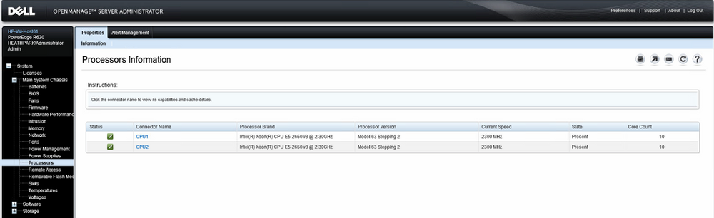

We've got 5 HOSTS in our current setup, 4 of the hosts are Dell PowerEdge R630
CPU: Intel® Xeon® E5-2603 v3 1.6GHz,15M Cache,6.40GT/s QPI,No Turbo,No HT,6C/6T (85W)
RAM Installed: 64GB on each host.
Was just wondering if our hosts could handle me installing and configuring RDS, definitely got the spec to run 2 virtual RDS servers?

As someone who does this kind of stuff for a living similar to your consultant it may be them erring on the side of caution if your hosts are already busy doing other things it takes away potential resources from your new RDS environment.
I'd be a little wary of your clock speed only being 1.6GHz it's rather low - won't stop you doing it but is something to keep tabs on if your users are likely to be hitting the clock hard. (not so likely as you said Office, Internet usage on the most part)

For 40-50 you should be fine virtualising the whole lot, just watch the clock speeds don't devalue your solution.
