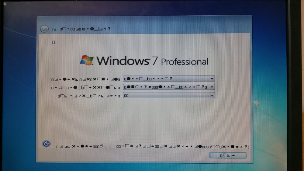

I re-imaged a machine using WDS and setup is coming up in the Wingdings font.
The PC is a Dell Optiplex 3010, if I re-image again it is possible that it will come up in the correct font.
sometimes it works sometimes it doesn’t.
