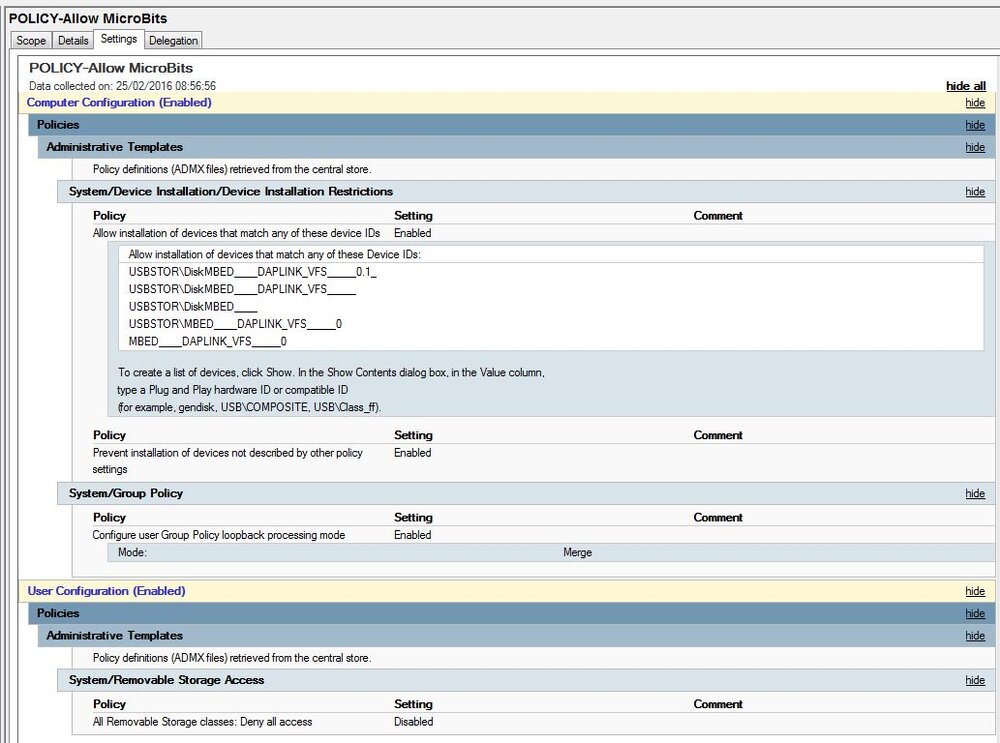

I have it working now:
Under Computer/policies/administrative templates/system/device installation restrictions/
Allow installation of devices that match any of these Device IDs:
USB\VID_0D28&PID_0204\9900023431864E45006C10130000005C00000000CC4D28BD
USB\VID_0D28&PID_0204&REV_1000
USBSTOR\DiskMBED____DAPLINK_VFS_____0.1_
USBSTOR\MBED____DAPLINK_VFS_____0
USBSTOR\GenDisk
GenDisk
STORAGE\Volume
No further settings needed (of course this gpo only work in conjunction with (Prevent installation of devices not described by other policy settings) same path as above.
if you don't already use this policy be aware that it will affect all new devices including usb kbd and mice even if you only move them between ports. it will however not affect any existing installs.
Driver restrictions and windows updates were all left unconfigured.
Hmm, we're using the "if it looks like storage, block it, if it's a peripheral allow it" options. Will have a poke about to see if I can amalgamate the two.

@chazzy2501 - Can you tell me which devices the top IDs represent? If you allow "USBSTOR\GenDisk" doesn't that allow the installation of any USB storage device?
yes, "USBSTOR\GenDisk" would allow any device with that Id but as no device would only have that singular reference it would still fail to install. Without this no usb storage device could be installed. the same as gendisk and storage/volume, without those the device would install but not mount.
