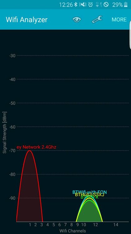

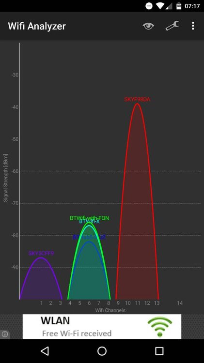

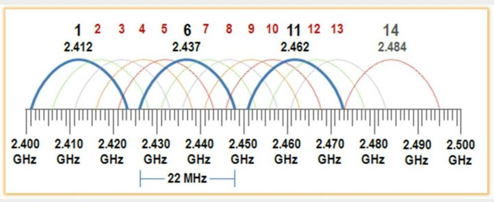

13 is no good if there are other strong signals nearby using 11... Parts of their range of frequencies overlap! Use WiFi Analyzer (or similar app) and find which of the three is clear or has weak competition. e.g Two of my neighbours are using 1 and three are using 6, but 11 is clear so I use that. Refer attached.
If there is too much strong interference, you might need to talk to your neighbours and see if any of them can swap channel? (The app can help identify which neighbour has which ssid too)

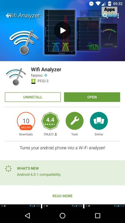

Android or iOS?
If the former, this is the one I use...

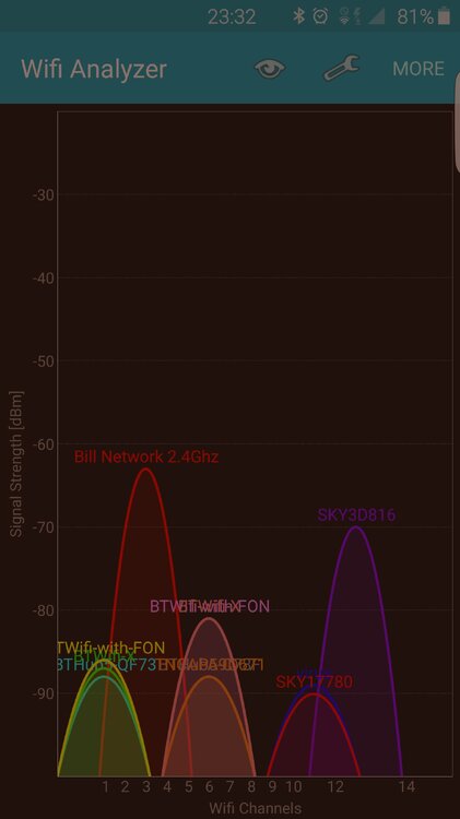

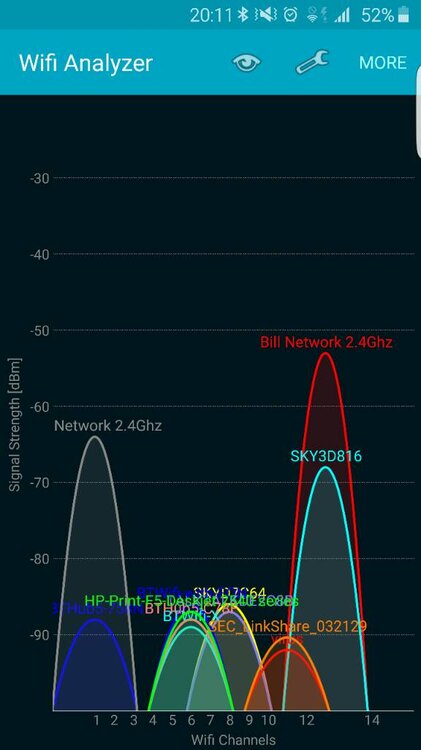

I have also since changed the 2.4Ghz back to channel 13 with use of that app. It's pretty congested in regards to wireless around here but the app shows that 11-13 where the best channels to have it on so we will have to see how it performs tomorrow.
Here's my graph if you'd like to have a ponder mine is bill network. It's pretty weak downstairs anyway so I think the additional AP will help when I'm upstairs I get close to 30db :)
My router won't allow me to choose a channel 14 it only goes to 13!!
