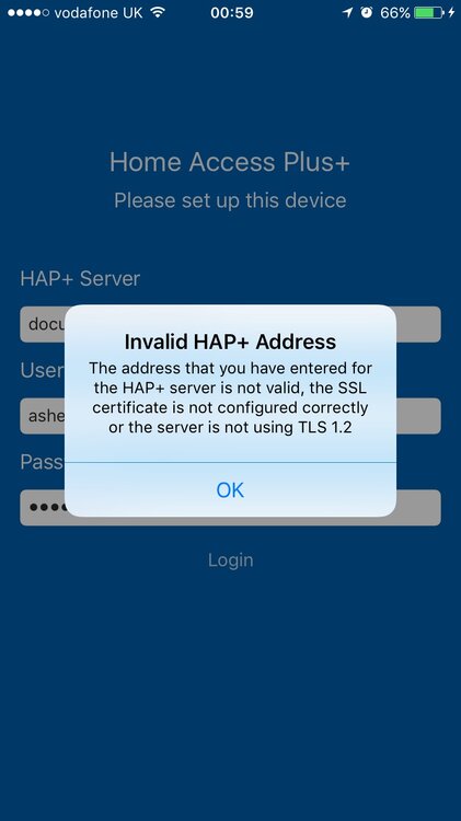

ass17 Posted June 1, 2017 Posted June 1, 2017 Strange that I've just tried to login again and it works???? Selected personal device and all is great! Only problem is that when you logout you cannot connect to another HAP server as it remembers the previous one. Right, it works because I'm at school on the school wifi. But outside or 4G then it fails. So is it a cert issue?
Stuajnht Posted June 1, 2017 Author Posted June 1, 2017 I'm getting the same issue. Could you PM me too? Or as there's a few, perhaps put it on here? Thank you Stuart ************* Update *************** I've turned my PROXY off and it now works. Does this mean it will work from off site? Normally the first step I ask for is to run a test against SSL Labs to see what the certificates are being shown as: https://www.ssllabs.com/ssltest/index.html I'll need to have a link to the results page that is generated, but as most people probably don't want to publicly list their school details, feel free to PM them should a problem not be obvious. Right, it works because I'm at school on the school wifi. But outside or 4G then it fails. So is it a cert issue? I would say yes, but it could also depend on how you've got IIS bindings set up and what listens when connections come in. If your bindings for port 443 have different IP addresses (normally: 127.0.0.1, *, ) then the certificates need to be the same for all.
ass17 Posted June 1, 2017 Posted June 1, 2017 Normally the first step I ask for is to run a test against SSL Labs to see what the certificates are being shown as: https://www.ssllabs.com/ssltest/index.html I'll need to have a link to the results page that is generated, but as most people probably don't want to publicly list their school details, feel free to PM them should a problem not be obvious. I would say yes, but it could also depend on how you've got IIS bindings set up and what listens when connections come in. If your bindings for port 443 have different IP addresses (normally: 127.0.0.1, *, ) then the certificates need to be the same for all. I will PM you our bindings now, if you could throw answers our way [emoji1303]
Stuajnht Posted June 1, 2017 Author Posted June 1, 2017 Hi all, For those of you who are having problems getting past the login screen, if your tests from the SSL Labs website are coming back fine, could you also check with this website too: https://apptransport.info/ This will let you know if the HAP+ server settings are compliant with Apple's App Transport Security requirements, or what changes may need to be made on your server to allow the app to connect.
