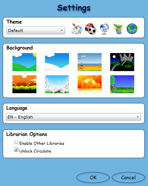

I log in on my machine with the full on admin account (not the librarian one) and unlock circulate in the settings. This allows circulate for all machines everywhere.
Edited by Joanne
[ATTACH=CONFIG]34327[/ATTACH]
Snap :)

The tick box "Unlock Circulate" is a per user option via Cookies, as I found out when the fix only worked for one person.
If you want to unlock Circulate for a machine, you need to install the Hardware Plugin, "ieplugin.exe", as described here http://documentation.microlib.co.uk/jl.net/plugin.pdf. It says it's only required for external hardware such as Identikit and says nothing about Circulate, but seems to enable that also!
