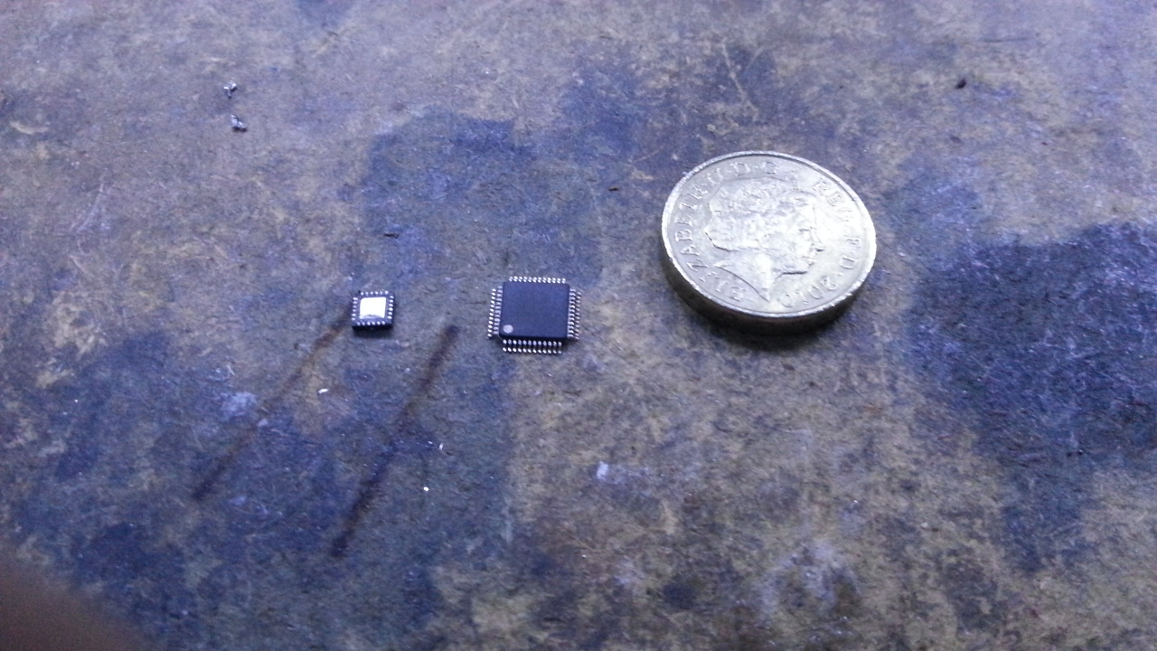

I see those sliders and pot and raise you QFN and TQFP48, removal and replacement :)[ATTACH=CONFIG]34306[/ATTACH]

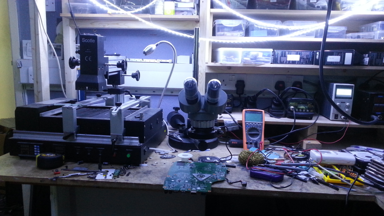

I highly recommend getting a microscope and a hot air station.IMG_20160113_140013.jpg

That TQFP48 is a common failure in Samsung and Sony TVs, costs less than a pound vs many for the TCON, and the QFN is common on laptop motherboards that are dead otherwise.
