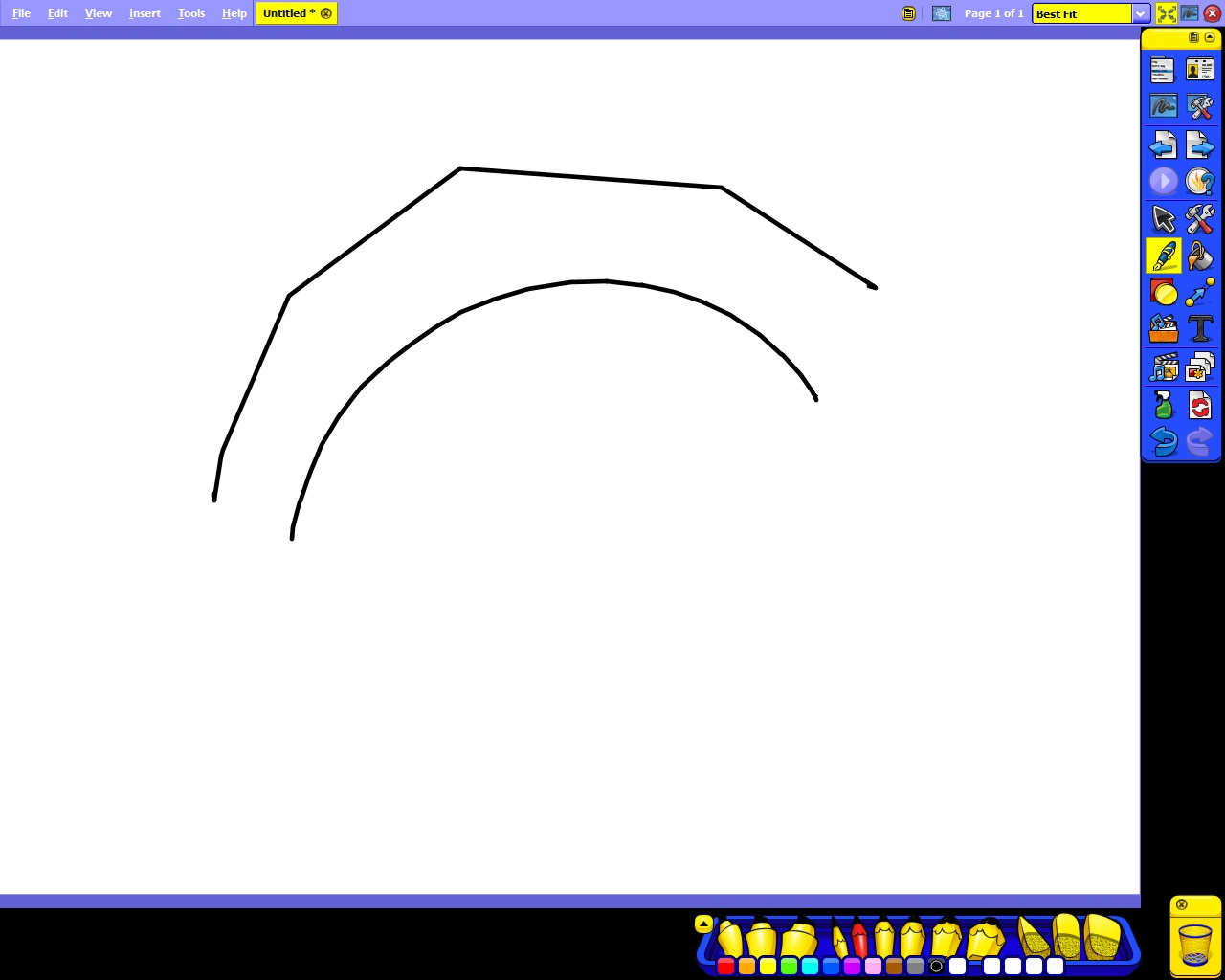

Well, fiddling with the USB power settings hasn't made a difference, so today I finally got round to switching everything over to serial (the PC didn't have a serial port, but an expansion card was only £15 on Amazon).
So it works now on serial, BUT, the response is so poor that you can't really write or draw on it. If you attempt a circle, you will get a polygon, that sort of thing, and handwriting you can forget.
That's an example of when I attempt to draw a curve, the jagged one is at normal speed, the smooth one at dead slow, is this the lagging that others have mentioned?
