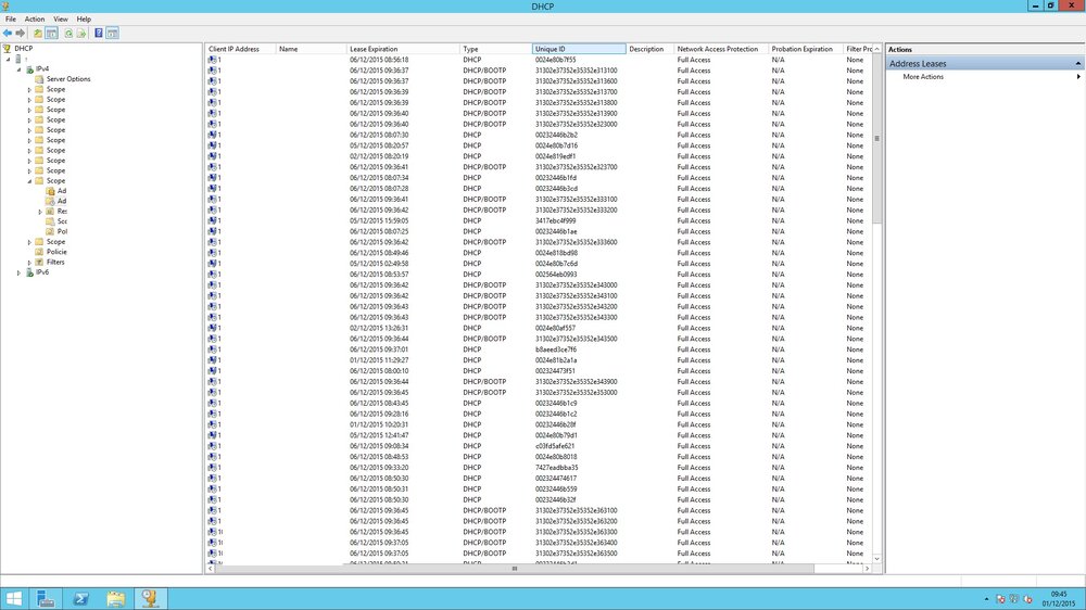

Mark182 Posted December 1, 2015 Report Posted December 1, 2015 FYI attachment... Anything that gets a DHCP/BOOTP won't get an IP address. Have tried to reconcile scopes they keep coming back.... Everything that re news does not get an IP address...
Steve21 Posted December 1, 2015 Report Posted December 1, 2015 I'm assuming the 1s are just the fact you cut off part of the end? As per the scope. If so what do you mean as it's showing IPs assigned :s Steve
Mark182 Posted December 1, 2015 Author Report Posted December 1, 2015 We have 11 scopes in total but only two ranges are pushing out TYPE = DHCP/BOOTP, all other scopes are fine and renewing leases. Two of them don't seem to be. As the lease runs out on a device it then won't get an IP address.

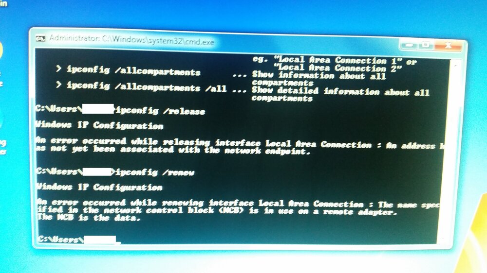

Mark182 Posted December 2, 2015 Author Report Posted December 2, 2015 Anyone ever seen this "An error occurred while renewing interface local area connection: The name specified in the network control block is in use on a remote adaptor. The NCB is the data. " We have rebuilt DCHP on our DC and turned off fail over, All windows updates installed. Really struggling with this. Seems when a device is restarted even though it has a valid lease before restart it then won't use that address after a restart.

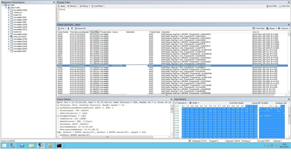

Mark182 Posted December 3, 2015 Author Report Posted December 3, 2015 A little update, used our shutdown to make sure everything was turned off last. Came in early and started to turn computer rooms on.....From the first post the dodgy MAC address is requesting all our IP address and filling up the scopes so no one can log in. I checked on the DHCP server last night when everything was off and all looked okay. I think it's wireshark time to see what continually makes DHCP requests to take up all the addresses.
Mark182 Posted December 4, 2015 Author Report Posted December 4, 2015 Just a little more information see attached picture. This IP 10.75.59.254 address is constantly requesting addresses. The 10.75.59.00 scope is our wireless (SID not broadcast) we stop dishing out addresses at .50 Whatever is it keeps exhausting our .54 and .55 scopes until there is no more left to dish out. If you that the IP address into IE it comes up with a page about the website’s security certificate and then you click continue the page cannot be displayed. When all devices are off at night time we don’t have to reconcile our scope but as soon as users come in and power on desktops ect then everything goes nuts. We have spanning tree enabled on switches and they are not maxing out any of them. It’s only happening on our .45 .55 range. We’ve tried shutdown commands on that IP address no joy

Mark182 Posted December 7, 2015 Author Report Posted December 7, 2015 I came in on Saturday to do some testing. I logged in remotely to our DC checked "reconcile" was all fine. I then logged onto the server once on site and checked again, all fine. I turned one random computer on one pops up in the reconcile box. I turn off that desktop and unplug from the network and reconcile, leave it 20 minutes check again all clear. Turn another random desktop same again. I go through the process a few times and same outcome. I have checked all our servers the RRAS role is not installed on any of them. It seems when a desktop boots up and checks it current lease that's when errors occur. We have rebuilt DHCP on this server from scratch so I am really confused! This "MAC" addresses all start "31302e37352e353522313XXX Anyone any ideas?
