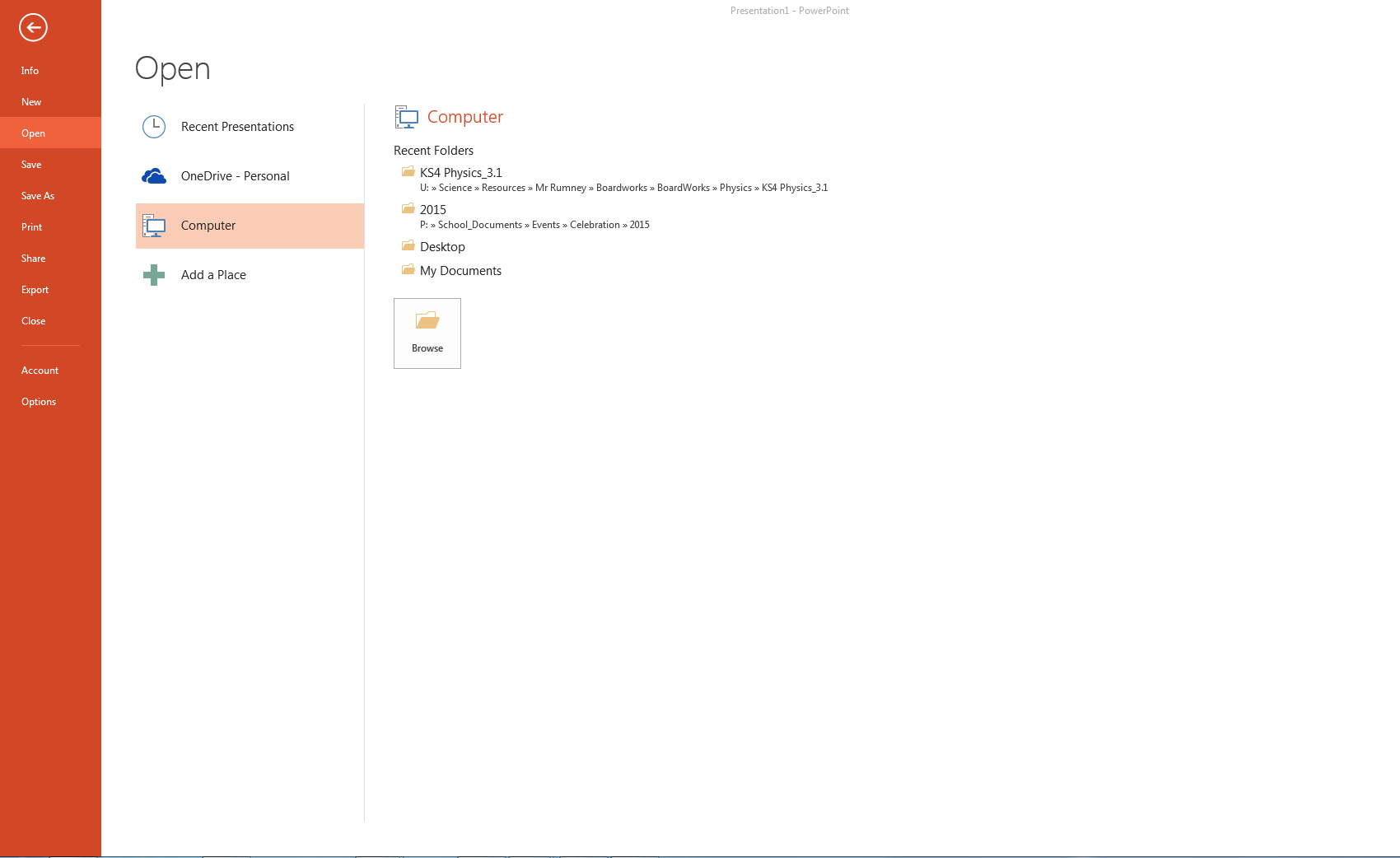

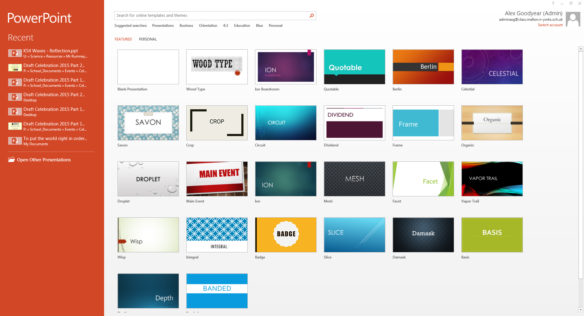

we dont use outlook with our end users, we make them use the web version, saves having to port pst/ost files around in their roaming profiles. So ive not experienced this in outlook, but powerpoint and word will all through this error withing 40 seconds of starting it.
Interestingly if they close it and immediately re-open it it works fine.... then giving this error again at the save point. We've round that using F12 rather than the office button to be more reliable. Im convinced this issue is around these sorts of pages (anything with a side menu:
