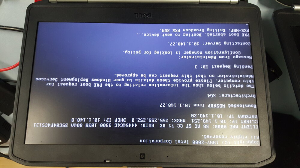

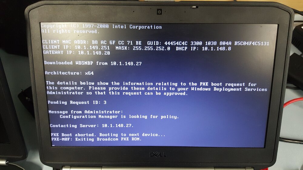

Is it before you even get into the PXE boot? As in at the PXE boot/command line etc? Yes (see screenshot)
Do you have multicast on, if not is the pxe boot on the same vlan as the SCCM server? It does detect the server but gets no further, we have very few vlans

even though I have a new HDD in the laptop obviously the NIC is the same as is still assigned to the old laptop somewhere in SCCM.. Deleted the laptop once I found out which one it was and BOOM!!!!!!!!!!!!!!!!!!!!
