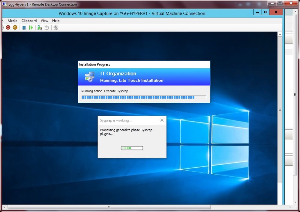

garethEds Posted December 11, 2015 Author Posted December 11, 2015 No @User0 - I've given up to be honest as it's a busy time of year with my teaching. I've even given up playing with manual installs of Windows 10. I feel Win7 is servicing the needs of the school just fine at the moment so I'm not rushing. After reading some of the threads on Edugeek I think it will be a while before I bother again. Gareth I've just tried again with the latest version of Windows 10 Enterprise and the same issue is apparent with freezing during the sysprep phase. Here is a screenshot.
IAMCloud_Curt Posted January 15, 2016 Posted January 15, 2016 I've just tried again with the latest version of Windows 10 Enterprise and the same issue is apparent with freezing during the sysprep phase. Here is a screenshot.[ATTACH=CONFIG]33882[/ATTACH] Any chance you could send me your rule settings and bootstrap.ini settings for your Reference Share?
